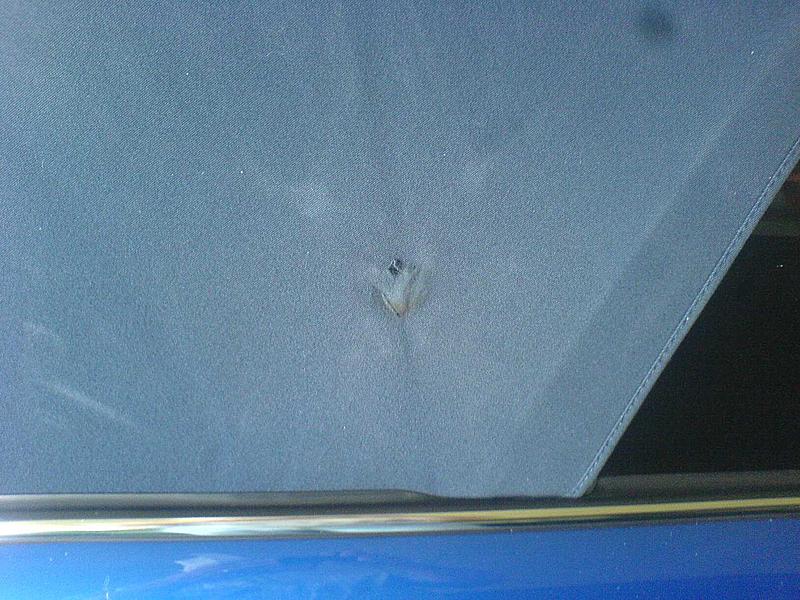

How would you handle my situation: Before the warranty ran out, I notified the dealer that the top seemed to be getting pinched in the folding mechanism. The dealer said the burnished mark on the fabric did not warant top replacement and service request was denied. The request and denial was recorded on my service ticket.
Now at 56k miles, the top has developed a hole in the burnished area. I called the dealer (different city) and the service adviser was less than helpfull and never called me back. How should I go about getting the top replaced under warranty (as the cause of the problem was there before the warranty ran out and I notified them)? Should I call MINI directly? If so, who?
Thanks in advance for any advice given (good or bad

The picture does not do it justice, but it seems obviouse to me that the fabric is being pinched in the folding (scissor) mechanism of the top.
Well, MINI/BMW threw me under the bus and totally denied any assistance at all. They claimed it was normal wear and tear. How is that possible when the "wear" only occurred on one side of a sysmetrical top? Total BS. They then said that the SA dealer Service Manager said it was not getting pinched in the mechanism. How could he know this as he never even looked at the car, not once!
So, yesterday, I opened the top in stages and peeked behind the headliner. Sure enough, the top was getting pinced between two arms of the top mechanism. More precisely, the lower arm has a 2" x 3/4" "finger" that I suppose prevents sideways motion on the top while it is being lowered. The top fabric is getting pinched between this "finger" and the upper bow shaped cast iron arm of the top.
So, MINI did not stand behind their warranty and calls it normal wear and tear. I suggested to MINI that that was like saying if one wheel had brake pads that wore out way before the other (on same axle) there was nothing wrong and it was normal wear and tear...total you know what.
So much for being a loyal BMW Owner for the last upteen years! I am so mad I can spit.
Make an appointment with said service manager and show him the pinching you described and see if he concurs. Be polite, until the final answer is no, then you can express your feelings.
Or, take a short video of the pinching and ask MINI USA where you can send it so they can see what you are describing.
Here is a photo of the top being pinced between the "finger" and upper arm. Seems that both my MINI and MINU USA/BMW NA are giving me the finger. Sure normal wear and tear and "I mistreated the top somehow" What a crock of ****

Update!
Received a phone call from MINI of San Antonio. It seems MINI USA approved the replacement of my top at N/C. So, thank you to everyone that offered advice. And like I said earlier if MINI USA did the right thing I would let everyone know and heep praise on them, which I am now doing. My faith in BMW has been restored fully and I appreciate the customer service more than I can show with this post.
I have an appointment next Wednesday to have the top replaced.
