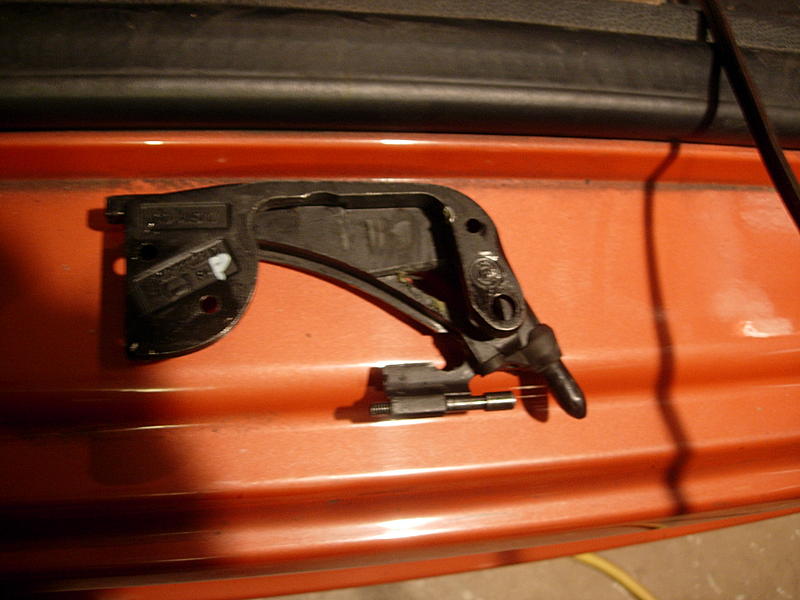

Well, after a couple of happy weeks motoring with the top down, the right side cable came out again
, so I'm fixing it this weekend, this time using J-B Weld to bond the cable and latch together.
Im putting together a complete video on how to disassemble the convertible top and repair the cable latches this weekend and should have it posted in a new thread sometime this week.
, so I'm fixing it this weekend, this time using J-B Weld to bond the cable and latch together.Im putting together a complete video on how to disassemble the convertible top and repair the cable latches this weekend and should have it posted in a new thread sometime this week.

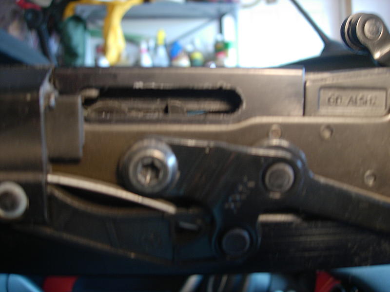

My hot orange toy broke the other day, this was the first place I stopped for help. You guys (particularly Not4no1) have been a savior to me, the instructions and diagrams have allowed me to hopefully save myself and others a ton of money. I haven’t completed my repairs, but I’m ready to help others get their tops apart.
Hats of to the engineers, this mechanism is a work of art.
Getting that front top piece out of the way. I took all the screws out, only to find out that the outer two screws are all that matter. I took the hard way of getting the top off first, then getting the mechanism moved back. Releasing the rail mechanism took me days to finally figure out. What you have to do, is work the latch down from the outside of the rail. Once that catch is moved all the way down, the you should be able to work the top back without breaking anything.Attachment 48037 Attachment 48040
Remove the top motor.
Slide the top back so that the rail clamps release from the front windshield frame.
I had to remove four screws to get the front rail piece off. Three from the side of the frame, and one on the front end that you can't access with the frame attached to the front windshield frame.Attachment 48041 You can see this screw once the frame is released and you pull the frame up and look straight on at the rail assembly.
Once that font piece is off, the assembly slides off the rail and you can push the cable out of the rail.

Hi Scott
I have had the cables break on mine and this isn't your issue if the sunroof comes right back on both sides. I however have also had the broken locking hook problem and there is a thread on it here https://www.northamericanmotoring.co...tible-top.html
The good news is that it is easy to get at and repair yourself - I managed to successfully repair mine with 'JB Weld' - but the parts are not that expensive.
