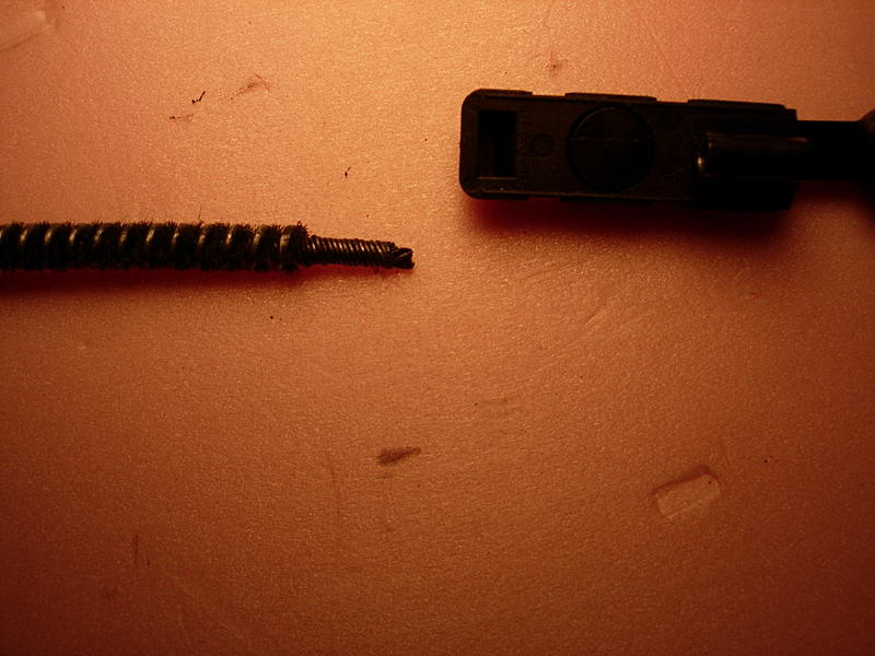

Broken cable discovery
Once I cable got my cable out and giving it a good hard look, I made a discovery. Nothing was technically broken.
On the first picture, I have a detached cable and complete carriage assembly. The cable would not just slide into the assembly, so when you examine it closely in the second picture, you can see machine marks where Mini used compression to hold the parts together. So I'm off the the machine shop to get some help.

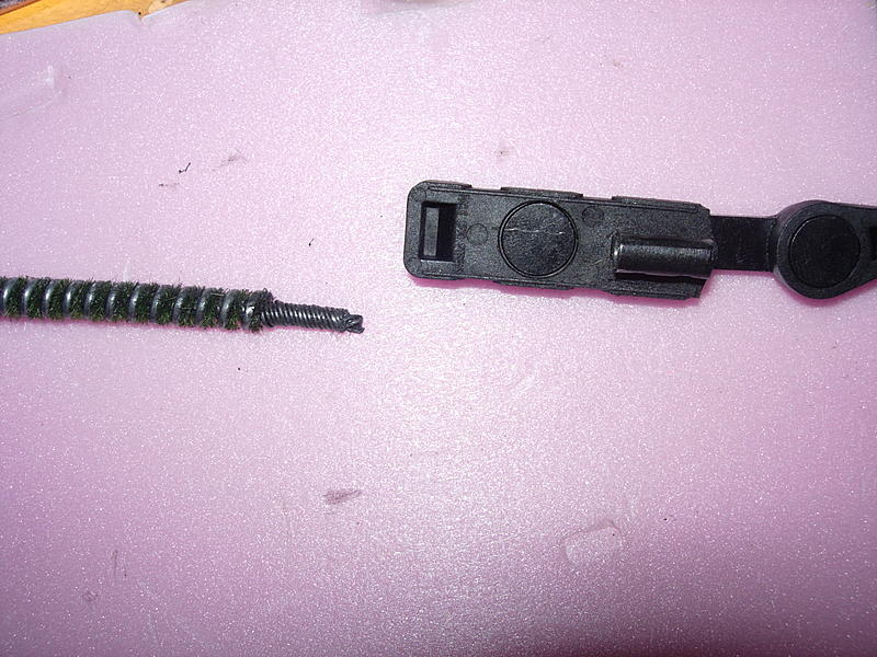

I tried to explain to the dealer that I thought the stop on the end of the cable had come off and that my cable was not actually broke but they did not agree. I did not fully take it apart but noticed the following...
After removing the interior plastic trim panels I would start the opening of the top to see the movement within the latch mechanism and noticed on the lower side a "tab" (near the arrow in the attached photo) that moved as soon as I pushed the opening button - first up and then back and into the latch mechanism. On the failing side the piece also moves but does not retract - it actually can be moved back and forth with my finger as it is not connected to anything (unlike the working side that disappears into the latch) When I press the close top button the tab on the failing side moves and then becomes tight as if something is pushing on it (I assume the cable but cannot see it). Based on the issue you had with your cable, does this situation sound similar to yours?
What was involved in the repair and can you offer any advice or suggestions we should keep in mind when we visit a machine shop?

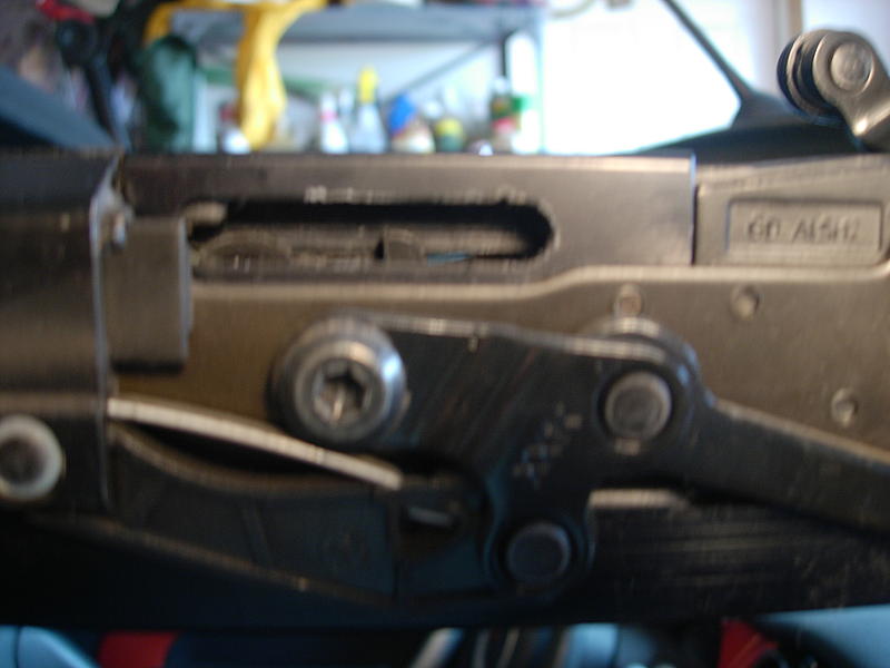

3. Manually unlock the front latches, then unlock the mid rail latches.
4. Place front locks back in closed position when top is partially open
5. In the front of both rails, there is a black plastic tab, you need to push this down and back so it slides in place
6. with a flathead screwdriver, place screwdriver between the front latch (which should be closed so the tab can move back/forth) and the black plastic tab. Push screwdriver handle towards the rear of the car until tab pushes in and releases the sunroof mechanism lock.
7. hold the rail with one hand and the top of the hood with the other. push back until it opens. make sure you have your hand holding the rail far back so you dont pinch your fingers (which I did).
Once you have enough slack, you can remove the canvas from the front cross-member by unhooking the tabs in the front, then sliding the canvas forward then up. There are wire hooks attached on both sides of the cross-member that need to be unhooked.
Also, once I removed the latches, I noticed that they weren't broken, just that the cables pulled out from the latches. All I did to re-secure them was clean/tighten the threads from the cable, screw them back in, crimp the tube that the cables slide into, and (almost) good as new.
I'll let everyone know how they hold up, but I tested it about 20 times and they're still good. ~$450 saved and about 4 hours of time.
Just fyi - anyone in the Long Island, NY area that needs help with their top, I wouldn't mind lending a hand to fix yours for some beer in return
Thank you to everyone that contributed information in this thread / board!!!! You guys (and gals) saved me ~$2,500 in repairs.
