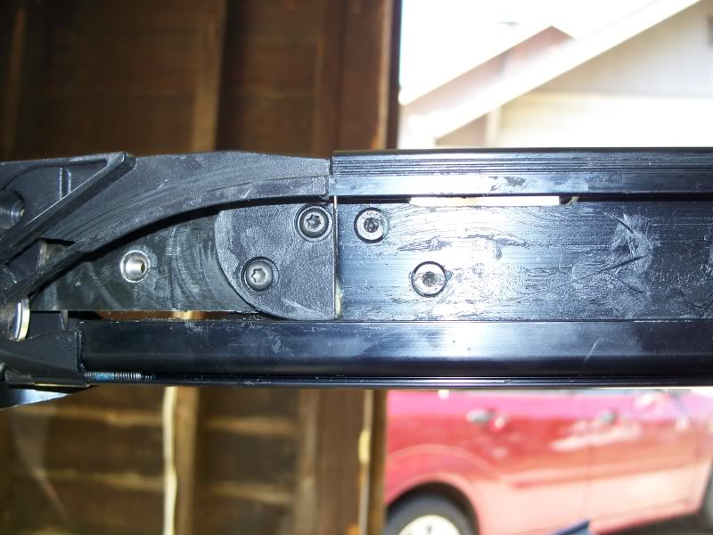

Some pics

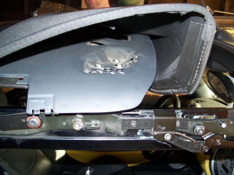

Ok, I've started to dig into this. Only I can not get the right side mechanism to slide back at all! It is not being pulled by the cable drive. It appears to have become unattached from the cable at the bottom edge of it where the cable slides through the track and secures to an end anchor?
Sad Sight

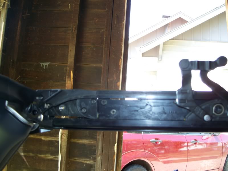

The stuck side looks like this
The side that still moves looks like this
Anyone know how to get this all apart? I can't get the cassette on the right side to move back. If I could get it apart I might be able to remove the rail and reattach the cable or replace the rail / cable.
Anyone have any advice? I know the cable comes from the motor in the center of the roof.
I think I might have to remove the whole fabric cover to get to motor to replace the cable if needed. But the right side cassette must be moved somehow?

FIXED
ITS FIXXED !
Well after about 10 hours of labor to tear apart and put back together it is fixed.
It required $406.00 worth of parts from the dealership after 15% discount.
The parts only come in pairs for both left and right sides. (I used only my right side parts) It is pretty difficult to do this the first time. (And I hope to never do it again)
See pictures with some explanations here:

I first removed the trim pieces on both sides of the roof structure.
You will open the door & look up into the rail & you will see some screws. Remove those & one of the panels comes off. That should reveal more screws that will release the other side of the rail panel. You might have to wiggle them loose, but there are not clips holding them on.
When you are sitting in the front seat, top closed, look straight above you. There is a plastic piece that runs along the whole edge of the interior metal piece that the front of the top is attached to…I will try to take a picture later. That is what needs to be removed. It just pulls off.
Under the plastic is a fabric strip that is glued (double sided tape) all the way across & a couple of metal clips that were holding on the plastic strip (caution the clips are sharp…cut my wrist, so you might want to cover with tape or be more careful). Wash your hands before you start removing the fabric (so you can reuse the tape) Start on one side & peel away. Take your time. A heat gun may help, it was pretty warm on the day I did this so that wasn’t necessary. This will release the slack you will need to get to the screws that attach the front of the top.
Now you will need to open the motor door in the middle of the top/interior. This door is held on by 2 loose fabric straps. It will probably fall off while you are working on your top. Mine did & so did someone else’s whom I talked to, but it snaps right back on. You just have to remember next time that if you open that motor door again, it might drop down & hit you.
Now you have to lift up your back seat up & remove the hand crank under there (check your user’s manual)
Slowly crank back the top. Just crank enough to get to the screws. Only one side will move (or these aren’t the instructions for you) This will allow some slack so you can get to some screws that are holding the front panel of the top to the sliding mechanism. I had to pull the plastic edging back along the edge to reach the screws. Opening the boot's reverse hinge will give you slightly more slack in the front.
The working side is very easy to access the screws & remove the top. The broken side will take some pulling to get enough fabric to allow a screwdriver access. If you have a right angle screwdriver, it will make the job much easier.
Once the top panel is removed, you can lift the front of the top up and fold it back over the car so you have a clear view of the side rails.
Now compare the broken/locked side with the working side & you will see how to unhook & slide the broken piece back.
Once you slide that cassette back, you will be able to access the screws that release the front of the rails.
Remove the 2 allen(sp) screws on the front most piece. Now wiggle/lift the rail to slide the front most piece off that you just unscrewed. Now you can access the broken cable that should be running along the bottom edge of the rail. Before you pull the cable & mechanism out, you have to access the mid-roof motor.
Open the mid-roof motor door (if you closed it) and disconnect the power from the motor (just a small plug) Now unscrew the motor (3 screws) Hold the motor in place, it is heavy & will fall down once the last screw is removed. Place aside.
Now that the motor is out, you should be able to slide the cable & mechanism out of the rail. If you can’t reach the cable, look where the mid-roof motor was & you should see where the motor connects with the cables. Use a flat head screwdriver to slowly push the broken cable down the rail & you will be able to grab the end poking out of the roof rail.
Once the cable & mechanism is out, the new one slides in exactly the same as the one you just removed. If you forget between the steps, look at the working side. The trickiest part for me was lining up the new cassette mechanism with the old working one. It took a bit of trial & error, I also ended up taking the motor in & out several times until everything was parallel.
