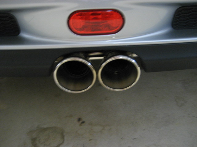

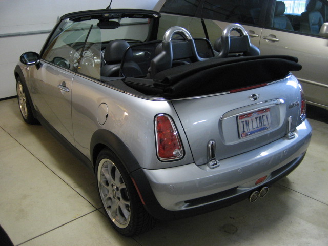

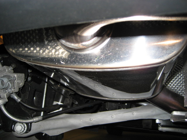

The system I put on my 06 Cabrio S was a Magnaflow, not a Borla as stated in the post above. I purchased my Magnaflow 16662 from hottexhaust.com and used the coupon code "hottsavings" for an extra 10% savings.

Ack - I started posting too early in the day, sorry. Just to summarize, the Borla exhaust for the Cooper will NOT clear the cabrio brace, but the Magnaflow exhaust for the 'S' *will* clear the brace.

Here are some pictures. I will post more in the next thread.
Attached Thumbnails Exhaust upgrade... installation issues with brace-img_1449.jpg   Exhaust upgrade... installation issues with brace-img_1450.jpg   Exhaust upgrade... installation issues with brace-img_1451.jpg

Here are more pictures.
Attached Thumbnails Exhaust upgrade... installation issues with brace-img_1452.jpg   Exhaust upgrade... installation issues with brace-img_1453.jpg   Exhaust upgrade... installation issues with brace-img_1454.jpg

One last picture.
Attached Thumbnails Exhaust upgrade... installation issues with brace-img_1455.jpg
