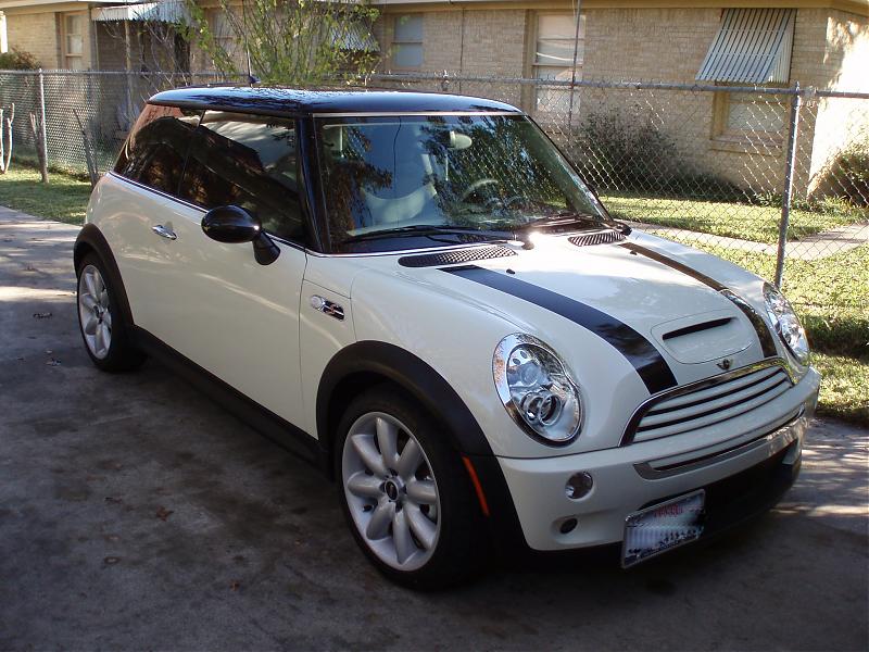

You'll like the tow-hook mounted plate arrangement. GoMiniGo is a good vendor. The kit includes locking nuts. I've had mine on for about six months, and everything is still secure.
