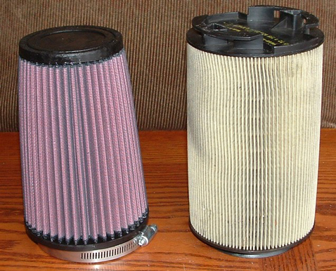

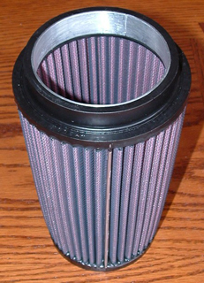

This project worked out better than I expected. The filter, with adapter ring, is a snug press-fit on the airbox neck, and K&N even supplied a hose clamp for it (band clamp to you Brits).
Pictures attached:
- The K&N RU-3130 compared to the stock JCW air filter. You can see the plastic parts on the top of the stock filter that mate to the plastic hanger bracket in the airbox.
- The adapter ring - 1/16" x 3/4" aluminum bent around a Campbell's soup can.
- The ring inserted into the filter - a perfect fit. To install, I pulled the ring out 1/4" and then slid the filter onto the neck of the airbox, pressing the ring flush with the end of the filter flange.

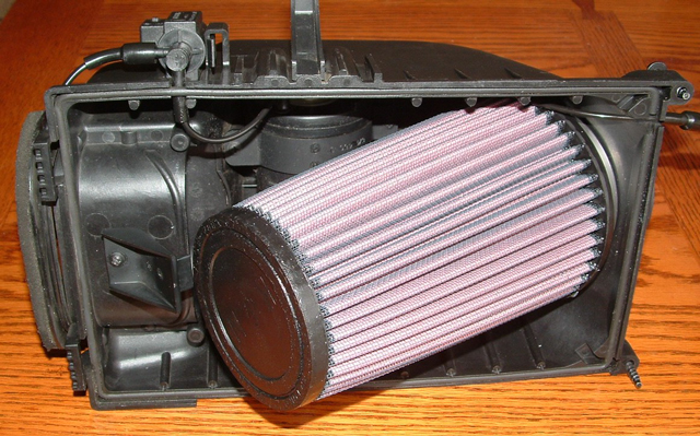

More pix:
- The filter and adapter ring, visible inside the airbox neck.
- The filter installed. You can see the angle at which the neck in the airbox points, and all the complicated airbox actuating stuff that keeps you from installing a larger filter or one straight in. You can also see the plastic hanger that holds up the end of the stock filter for want of a hose clamp - I left it there, because the screw would leave a hole into the intake, and to act as a safety stop in case the hose clamp and filter ever came loose (unlikely, IMHO).
This should put the JCW airbox right up there in performance with all of the other CAI's - about 5-7HP, but quieter than any of the aftermarket alternatives. Happy motoring...
