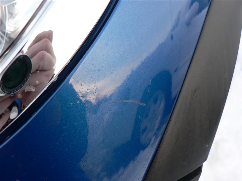

this morning after I had returned from a quick trip in the snow I parked blue back in his little snow cocoon and my girlfriend came out to help shovel the snow in front of her car. well I got in her car to move it out and she was still shoveling. I was just rolling the window down to tell her to not shovel near my car and I hear 'omg honey'... sure enough she put a 2" long scratch in the bonnet with the snow shovel! it's down to the primer too. I'm still grieving, but I can't make it obvious because she already feels bad enough... but damn. ohh well, not much I can do and it is just a car... but I'm still pretty upset about it. if it was on the bumper I might just use it as a reason to go get a aero bumper... but it's on the bonnet next to the headlight. I guess I'll call the dealer next week and order touch-up paint, but this sucks :(

here is a picture of the scratch... what do you guys think?

doesn't look too bad from the picture - a good body shop can fix it right up...

I would get some factory touchup paint, use a tooth brush, do about
10-12 coats in thin layers, let it dry a week, and then wet sand it
using 2000grit, polish, and wax afterwards.
should be able to take it to where no one would recognize it unless
you pointed it out.
I'm probably going to go next weekend to pick up the touch-up paint, but do you guys think it would be better to just claim it? it will cost me $100 for the deductible, but I'm thinking if I took it to a body shop they would exceed that because of having to remove the headlight assembly and remove the hood from the car. what do you think?
My cousin is an ASE certified painter/auto body guy and I'm sure he could mask the problem pretty well... but if it's still obvious I'm going to want to get it sanded out and at least that section painted. I'm worried that if I put touch up paint on it and get unsatisfactory results I may not be able to file the claim.
