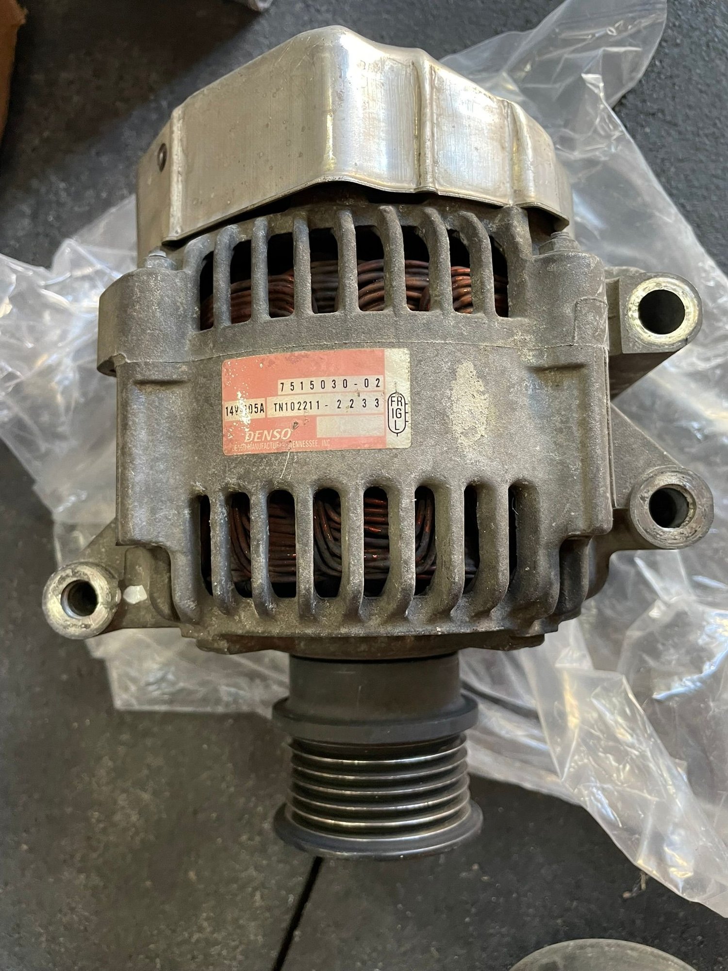

I'd like to rebuild the original unit. might just keep it on the shelf for now. it lasted 160+k miles. not bad
thought about allmagauto, but I don't want to end up with a unit that is probably close to end of life.

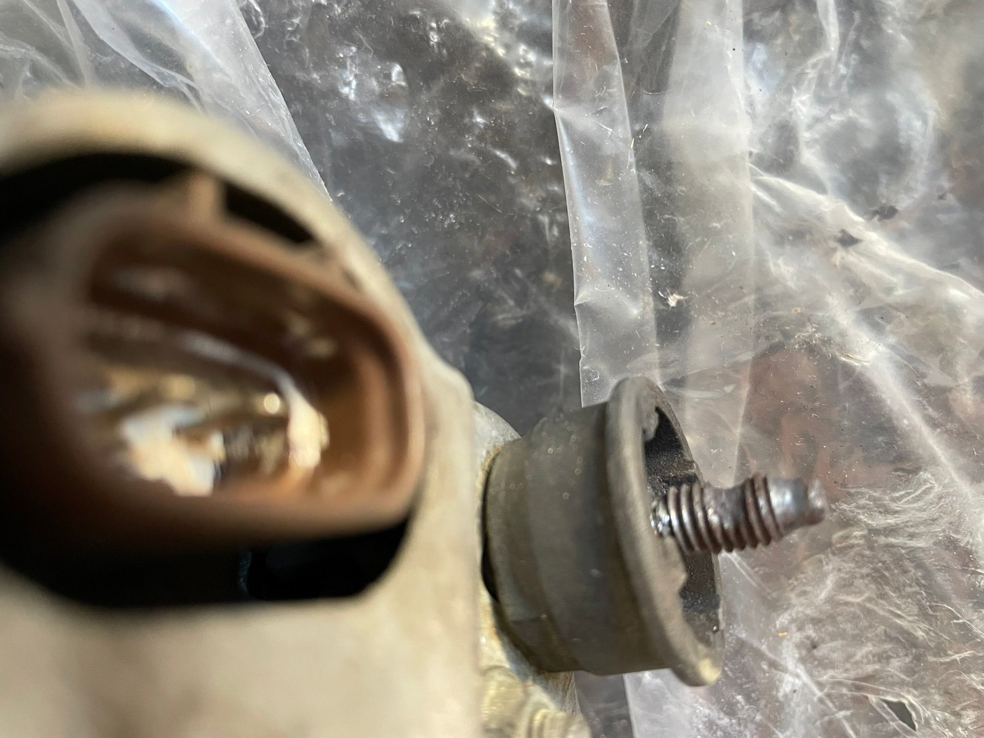

new alternator is in. the tyc unit. lets see how it holds up
the ground wire on the old one was not tied down. bolt was just not there. no idea how long it has been that way. probably years. must have been arcing cuz the stud is damaged

Old Jan 20, 2026 | 05:36 PM
Here2Go's Avatar
Here2Go
NAM Community Team
Joined: Jul 2021
Posts: 2,532
Likes: 1,608
From: Anywhere but here
No nut???...For how many years?!
cRaZy!!!
Old Jan 21, 2026 | 06:51 AM
Posts: 36,758
Likes: 2,548
Wow! I bet someone did a repair and then did not put it back on at the dealer or something! Yep i bet that toasted it over time.
