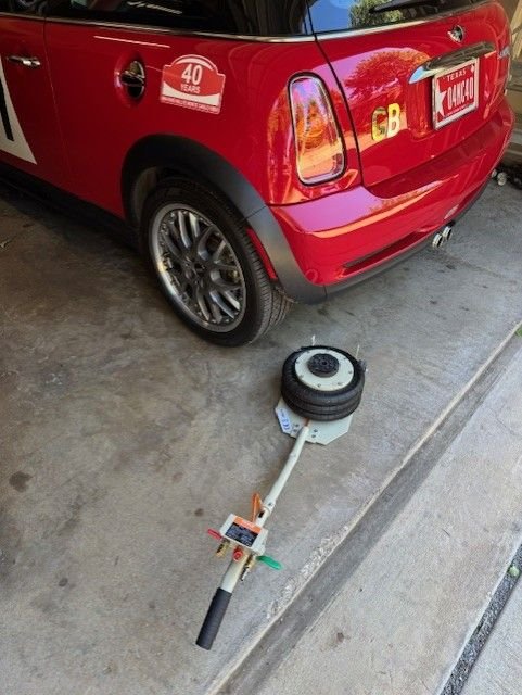

I have a pneumatic jack (air bag) that I use with my compressor. It will completely lift one side of the car so that you can quickly place two jackstands. It also has two wheels strategically placed (not in play when jacking) to ease movement. Hands down, it's the best and easiest jack I've ever used.

Pneumatic jack

Where are you locating the airbag on the car while lifting?

I use a 4-ft. 2x4 on top of the jack (see ModMini) between the jackpoints on each side. I've never had an issue with it slipping but you need to ensure that the 2x4 is securely placed against the inside bottom lip of the door sill. The jack can also be easily placed under each jackpoint since it has a dense round pad on top.
Those four jackpoints should already have an integrated pad but they're often missing. https://www.partsgeek.com/catalog/20.../jack_pad.html
