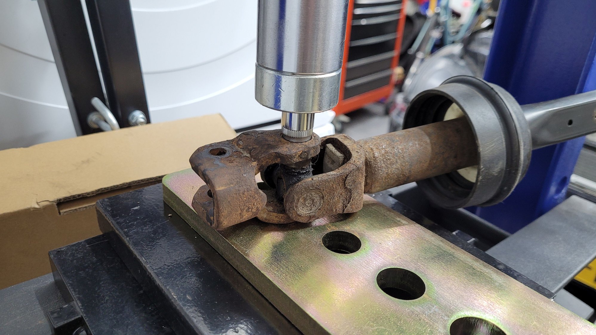

Also, the reason for replacing was the steering wheel wouldn't center after a corner. That's awkward and dangerous. The lower ujoint was frozen solid, I think spilling coolant was the final straw. I tried replacing just the ujoint but these are so tiny and so pressed in hard that I bend the ears of the shaft and the cups wouldn't point straight at eachother. Too bad, otherwise it would be a $10 job instead of $100.
Undoing that bolt from above
Inside the car
Inside the car
Fail
Fail

So, I cut off the bottom part of the UJ and this is what I found. As you can see in the first picture the bushing on the right has worn to a significantly bigger diameter that the one on the left. When measured with calipers it is about 100 thousandths of an inch or 2.5mm bigger that the one on the left. The other two pictures show just how worn it is, almost to the point of breaking thru on one side.
