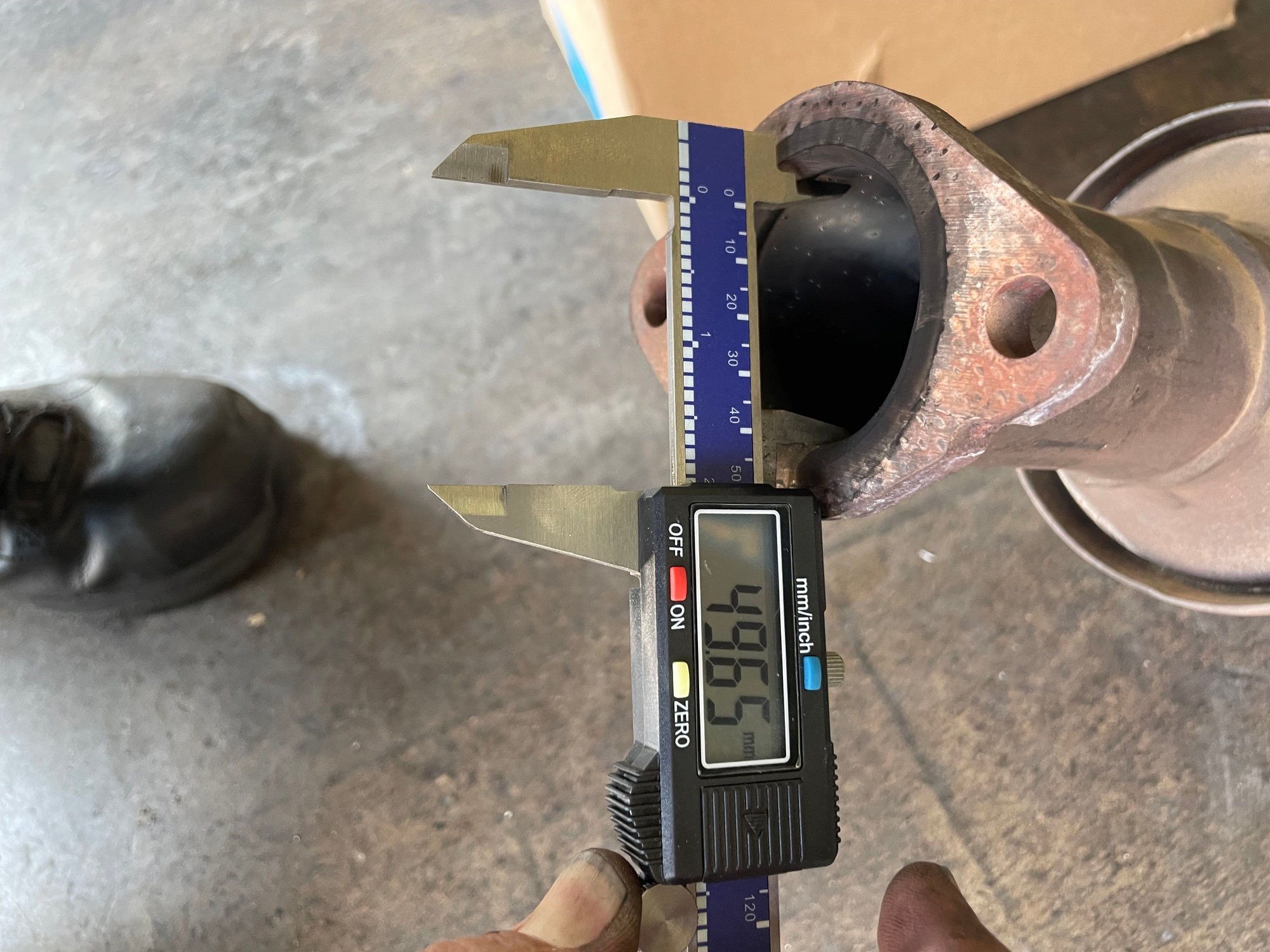

Well - to wrap things up in this discussion; I finally replaced my exhaust manifold complete with CAT.
Nope - I didn't go with any of those listed on eBay.
Since I enjoy traveling and exploring across our great nation in my Mini; I thought it prudent not to replace my failed CAT with a Magnaflow since I'm not sure where I might wind up next. (Eg: a failed emissions test in a state like California would be a real and costly bummer).
I was fortunate to score a low mileage OEM, complete manifold with CAT from a kindred contributor here on NAM. Long distance shipping was painlessly arranged. The manifold and Cat were and arrived in great condition. (I can't thank you enough Brad!). Having never worked on a Mini's exhaust system to this extent - Removal of my 22y/o,118k manifold went fairly well. The toughest part was manuvering the header past the swaybar. Not so easy considering I could only raise my Mini 13" off the ground... working in a Walmart parking lot. Upon extraction of the manifold, I was quite surprised when I shook it, to hear that the internal material in the CAT had not crumbled into bits but had broken loose intact, as one solid cone/mass. Installation of the "new to me" manifold was a bit of a pain trying to line up the header gasket, manifold to the head. I had unfortunately misplaced a M8 stud I had prepared in effort to help hang the gasket and header on one while I align the rest of the bolts. After a back braking 6hr day, I got to fire up the Mini.
It ran so smooth and quiet (like new), it was hard to tell whether it was running or not. No codes, no noise, no exhaust leak!
A few miles test drive tripped the SES. A quick scan revealed a fault with the post cat 02 sensor = heated 02 sensor malfunction. Id thought it most likely that I may have damaged the post cat sensor during the swap. I had a backup post 02, raised the car up just enough to replace the sensor. All is well. No SES, no codes, no running rich.
Ok that's all great. I'm loving the car again. But...
Now the biggest hassle (for anyone who may have gone through this), - Getting rid of the old manifold/CAT!?!!.
I scoured the Internet to find a local recycle yard. I visited at least 5. Not one of them would take my manifold with a CAT. I know I could get money in exchange for the precious metals in the CAT but still no recycler would take it, (Due to the large amount of nafarious thefts that have happened over the last couple of decades), Not even for free! After 2hrs driving from one recycler to the next, I was just about to give up hope and lay that thing on the side of the road. Until I came across a shabby, run down independent, metal collection/recycle business in probably the worst part of the SW valley. The man didn't speak English but his eyes bulged at the sight of the CAT and quickly offered me $50 cash. Yes I could have haggle and gotten more. But quite frankly, I felt he could use the money more than I and I was just happy (on many levels) just to have it out of my car and move on from this whole episode.
