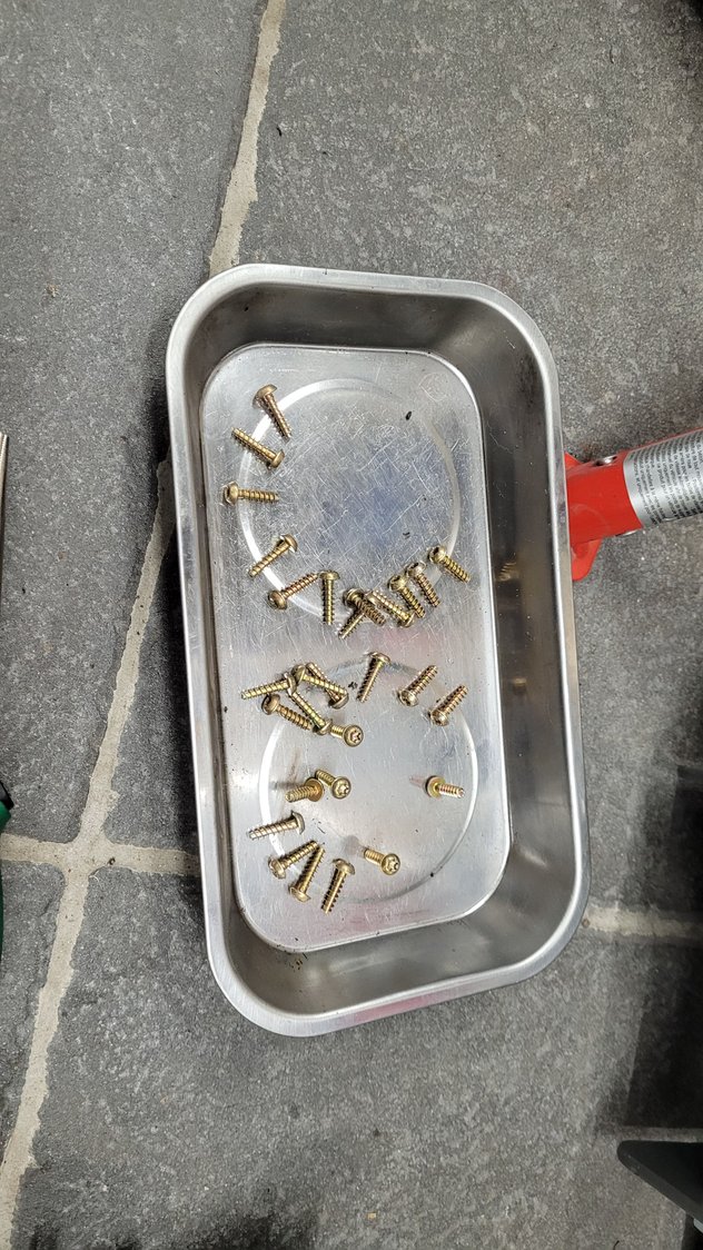

Make sure you take lots of photos every step, bag and label all the screws per item and label every connector. There will be 25 connectors, 100 parts to dissemble and a 1000 screws and bolts.

Step8. You need to disensemble the entire heaterbox. You cannot just split it, its build in wuch a way that you need take part a off before you can get to the last screw of part b and so on. Its all torx screws but not that straight forward. Basically undo the cabinairfilter box on the right first. Then take of all screws you can find. Note that some are really sneaky hidden, there was one behind the green worm wheel which you can only undo when turning the wheel to a certain angle.
