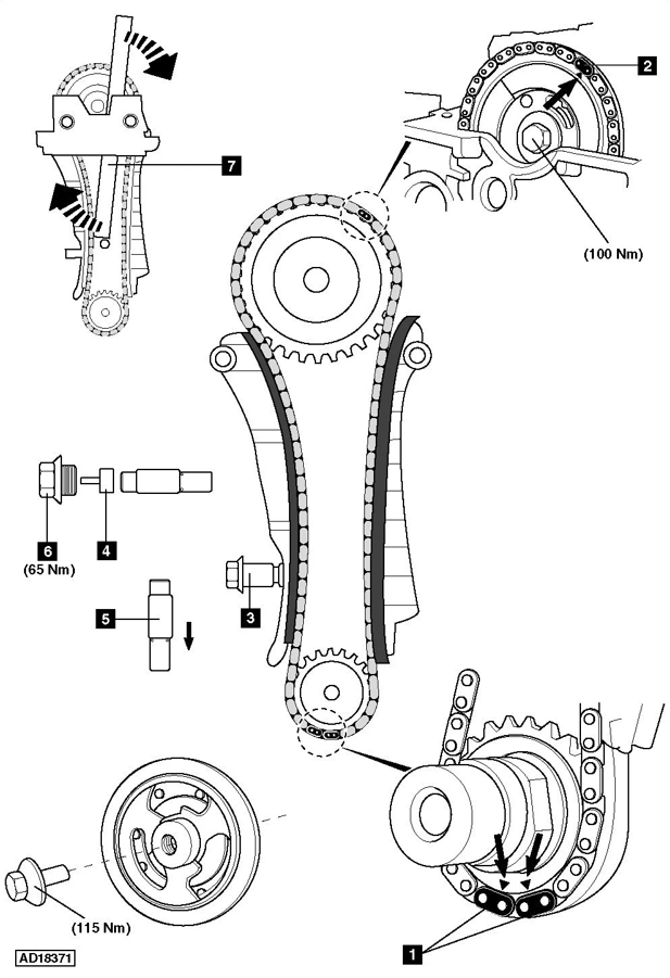

Timing aspect can be tricky to determine if its off. Even after doing a timing job the teeth will not line back up after a single engine revolution. I believe after a certain amount of revolutions they would but i have not found that process.
The only way to accurately time the engine is with the gold links and timing marks on the cam sprocket and crank. As pictured below, best of luck moving ahead.
