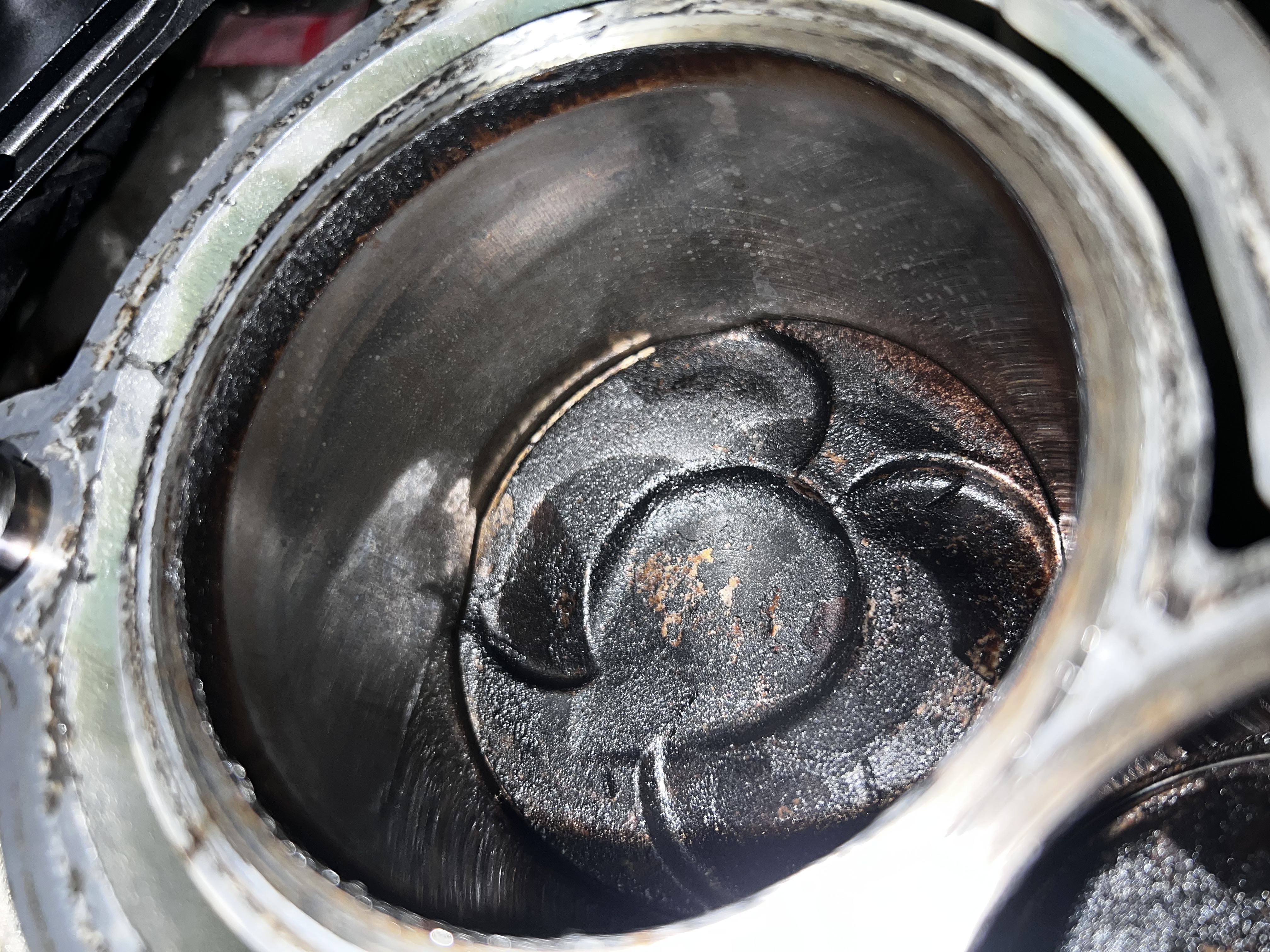

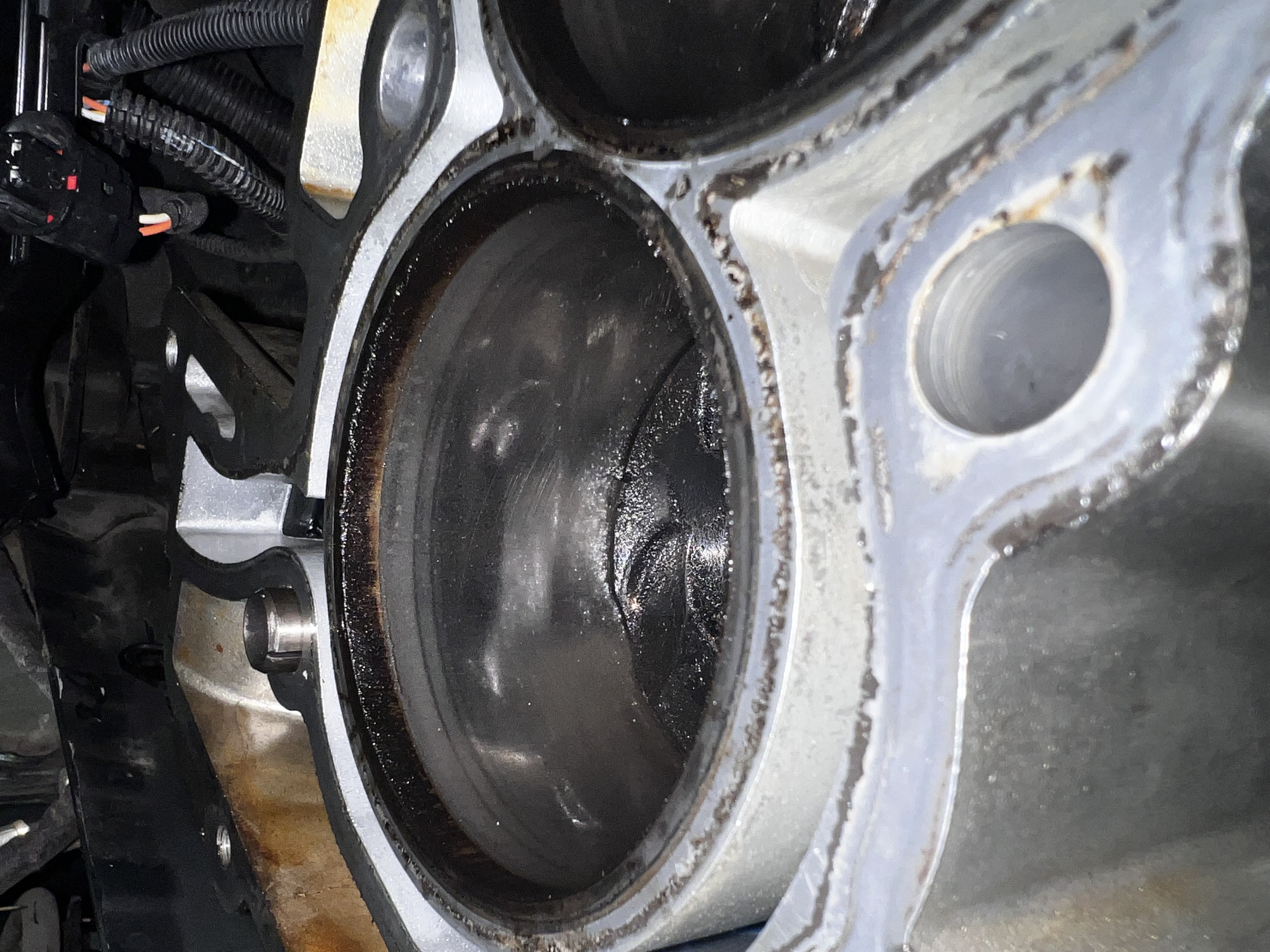

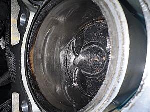

I’m looking down at my head gasket and block,
- head gasket has several cracks but not completely severe
- my rings and pistons look uneven next to each other around the edges. The shiny metal part peaking around the top of the piston I believe is the piston ring, it doesn’t look like a perfect circle all the way around the piston. On cylinder 1 of my added pictures you can see on the backside(when facing front of the car) the shiny metal ring is more visible vs around the piston nearest to me. On cylinder 2 you can see its opposite. On backside ring is not visible vs nearest to me it’s more visible.
Does this mean I need new piston rings & bore?
What else would need to be done besides having a machine shop resurface the faces of the block (might as well give them my head too) install wider pistons, bore, and rings?

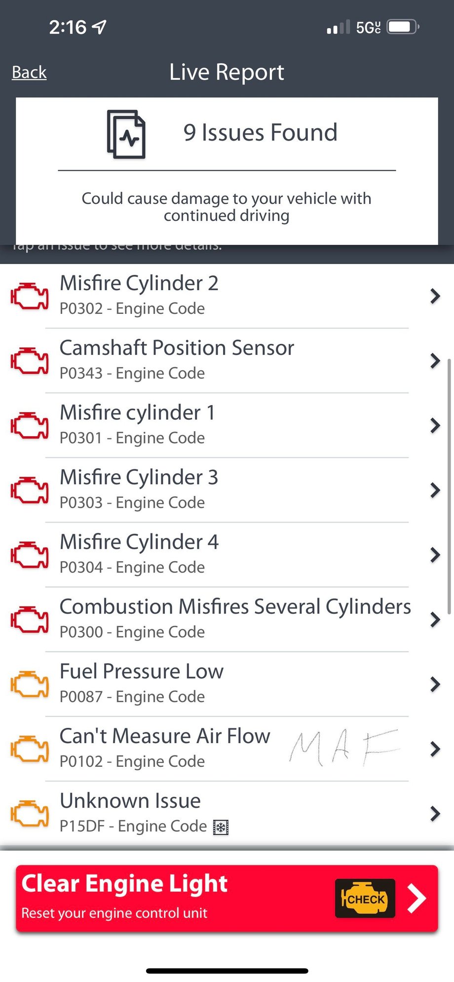

My BMW Foxwell codes are:
2789
2bee
2c01
2ef7
2efe
2eff
2f00
2f01
2f02
300c
EDIT: I've added better pictures of my bore and walls with their crosshatching. Is it reusable without a bore and just do 3 piece piston ring set?
Honestly, everything looks good. I'm not a professional mechanic or anything, but I don't see an issue. Maybe someone with more knowledge can give better insight. Especially after 128k miles. I can't tell from the sideways photos of the bores, but the overhead looks good. The piston rings aren't supposed to touch or be a perfect circle around the piston. So them not being connected is the way they are supposed to be. As far as your codes, I had no compression on any cylinder when my timing chain went. And my timing was in spec. But the chain was so loose when I pulled it out compared to the new chain. So I would definitely replace that since you got it, do a valve cleaning job even though I believe the N18 don't get as bad as my N14. And then get new head gasket, plugs and possible coils. Valve cover and gasket. Slap it back in and see what it does. Hope this helps!

Based on the faults you posted; low fuel pressure stands out a significant problem and will cause misfires; the "can't measure airflow" fault also stands out as it can also cause misfires. Camshaft sensors don't set timing; they only report to the DME where the camshaft is; timing is set by your timing tools; they hold the relationship between the camshafts and the crank when you install the timing chain. Make darn sure you have an quality torque wrench with angle. I have seen timing slip because the VANOS sprocket bolts were not properly torqued. If you have a Camshaft sensor fault, you have to troubleshoot to see if you have a timing problem (mechanical) or a sensor problem.
