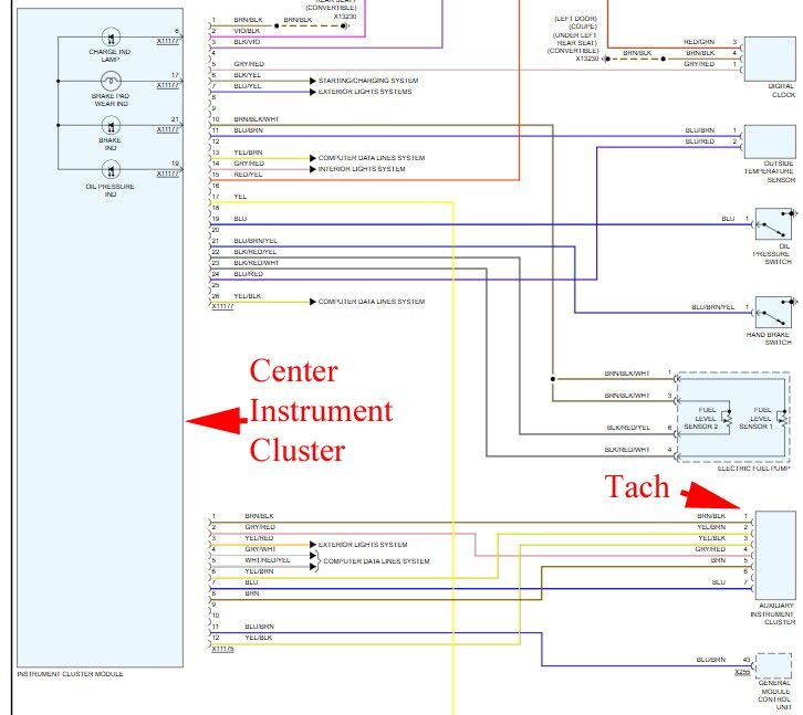

I noticed your engine temp is off the chart. That could be an electrical ground issue. According to the schematic, the 7 wires that connect to the tachometer are connected to the speedometer. You'll want to pull the center speedometer and check the wiring between it and the tachometer. I have read on this forum that some have had wiring issues between the center speedometer and the tach; they fixed the problem by piggybacking a new wire.
