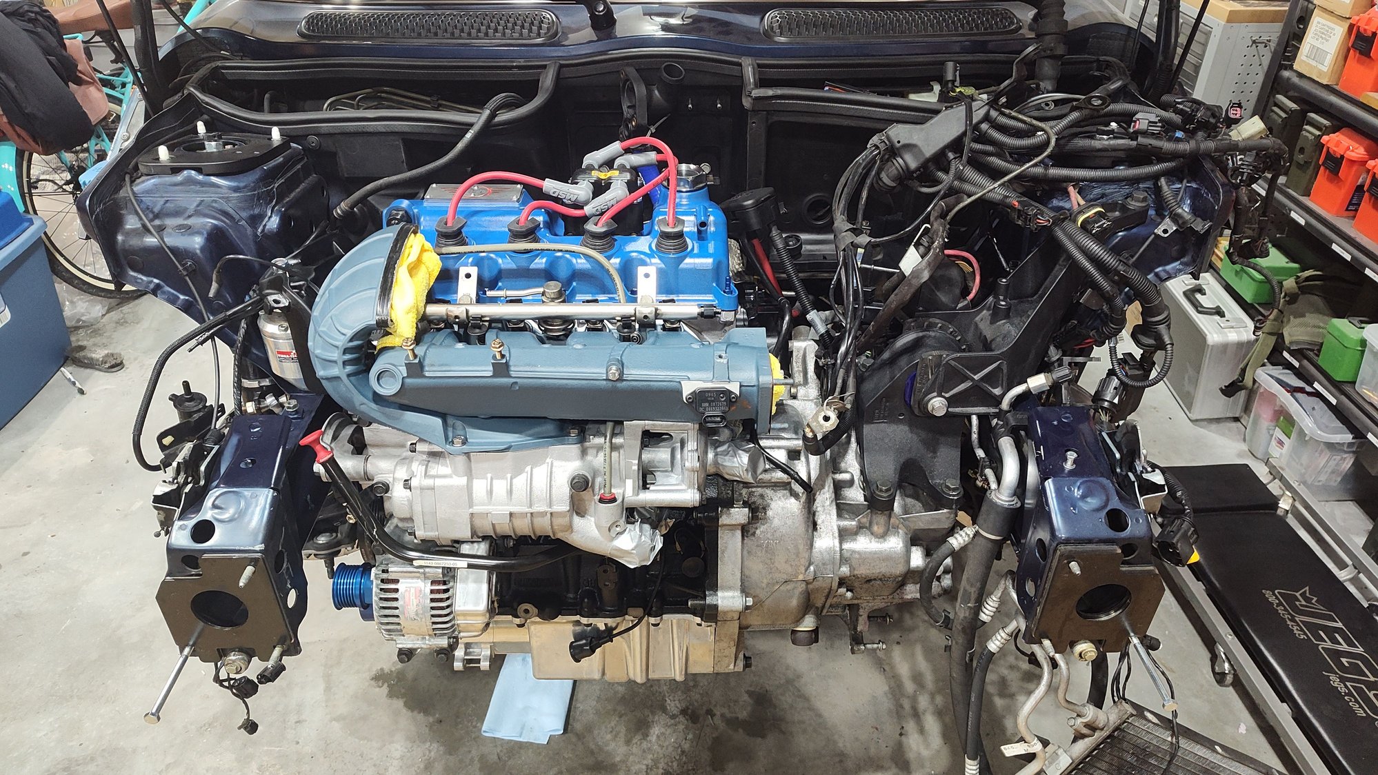

I'm taking too long at this, but quick update since I've made some progress. Motor is in. Pics attached. Maybe this weekend I'll get the axles in. Also shooting for the subframe to get bolted up. More to come.

what engine mount (right) is that? and the belt dampener?
looking clean!

The mounts on the engine side are stock, powder coated black. Just be sure to sand the powder cost off where they directly bolt to the engine. That's where your ground is and the motor won't run if the powder coat insulates the mount from the motor.
The passengers body mount is a Vibratechnics. They make one for the trans side too, but I'm good for now with poly bushings.
The dampener is an ATI with titanium screws.
I hope this helps.
