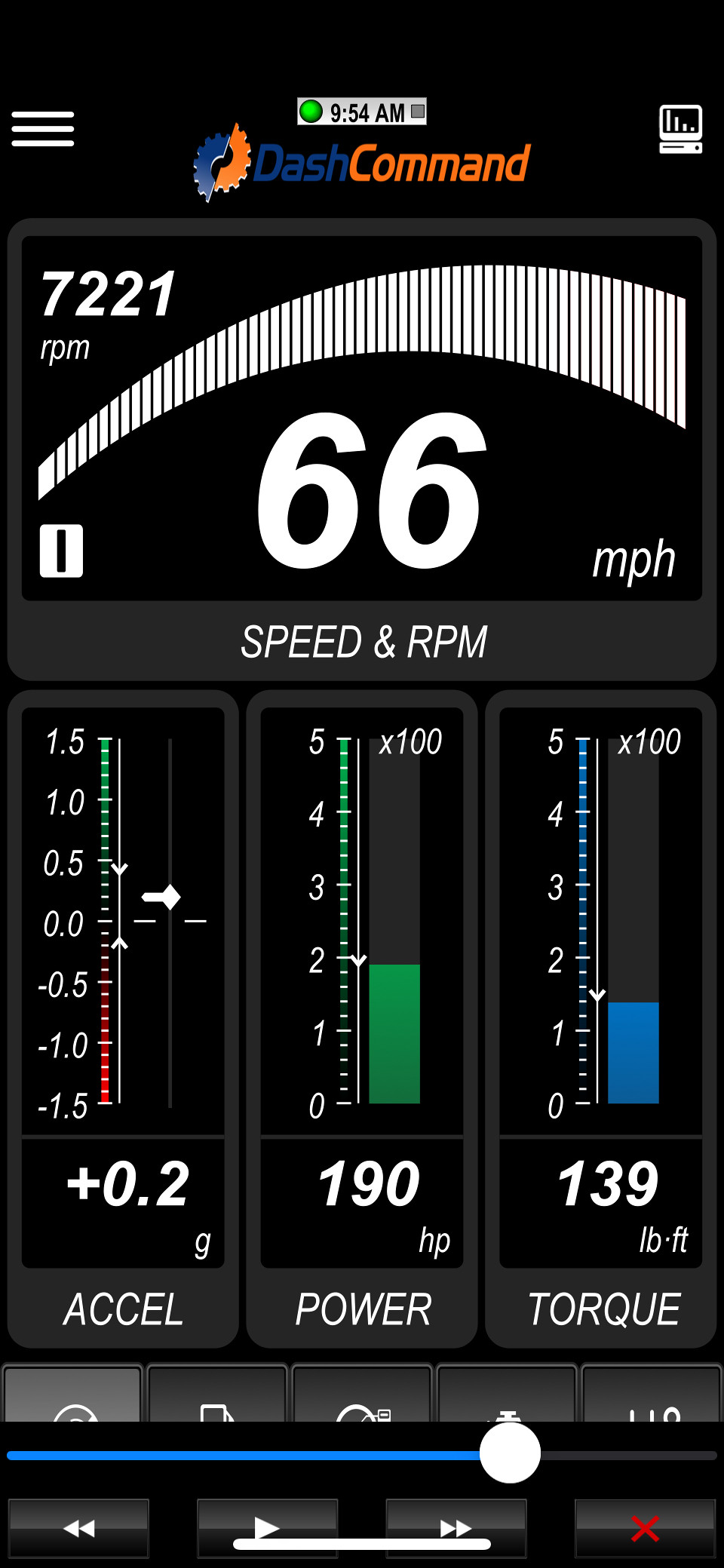

This means nothing but just for fun I used my USB dongle device + Dash Commander app to estimate hp...this interfaces with the ECU to give some real and some predicted data...anyway I did a 2nd gear pull today and it estimated 190whp at 7221rpms. That's pretty close to the numbers quoted early, and this isn't a real dyno. I did just one run, might do more when the weather is nice here.

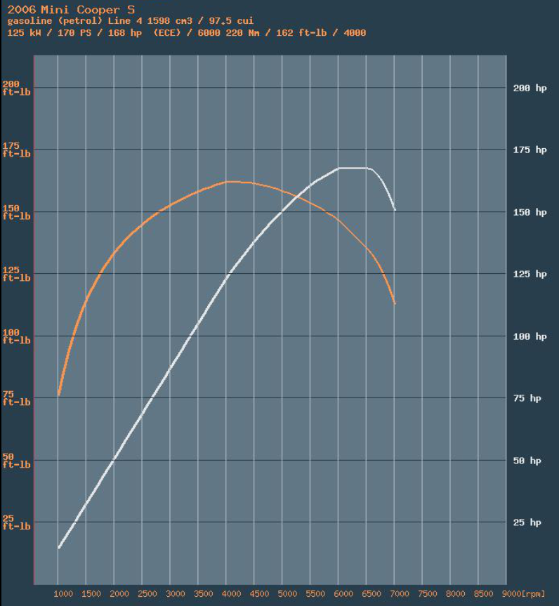

Thanks. Yeah 3rd gear is usually where they get peak numbers. Would you mind posting the graph, or if not, at least tell me what RPM peak HP and TQ arrived?
For reference I attached a stock graph (crank hp/tq), 168hp at 6000rpms, 162tq at 4000rpms. So on a stock car the power drops at redline. Curious about a tuned car with our mods.
