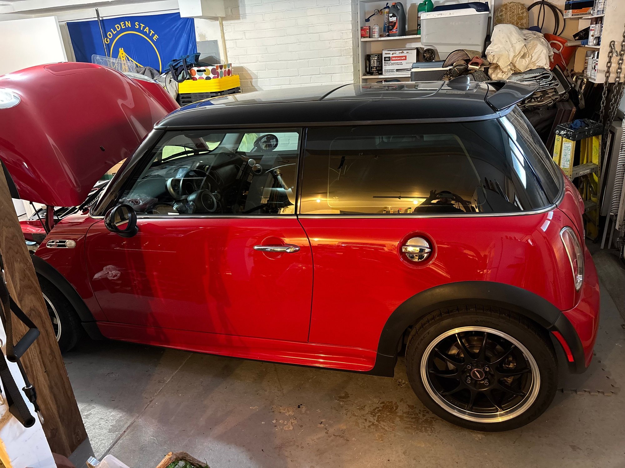

I recently went through the front end of my ‘06 JCW And went with Delphi ball joints and tie rod ends. They are made in Turkey and very cost effective. While the subframe is out, additional items you might need:
Inner tie rod ends, mine had 90k on them and had no friction.
Power steering hoses. They get weepy.
Also replace motor mount and bolt. Mod Mini has a video on this. Mine was dry and the bolt rusted on a rust free car. I got a cheap Uro dog bone mount for the lower since it’s easy to access.
I decided to use rubber sway bar bushings to keep things quiet.
The Powerflex control arm bushings are smooth and quiet so far! The harshness is gone! I was considering new springs too but with all these items replaced and new Conti Extreme Contact tires I’m loving it!
