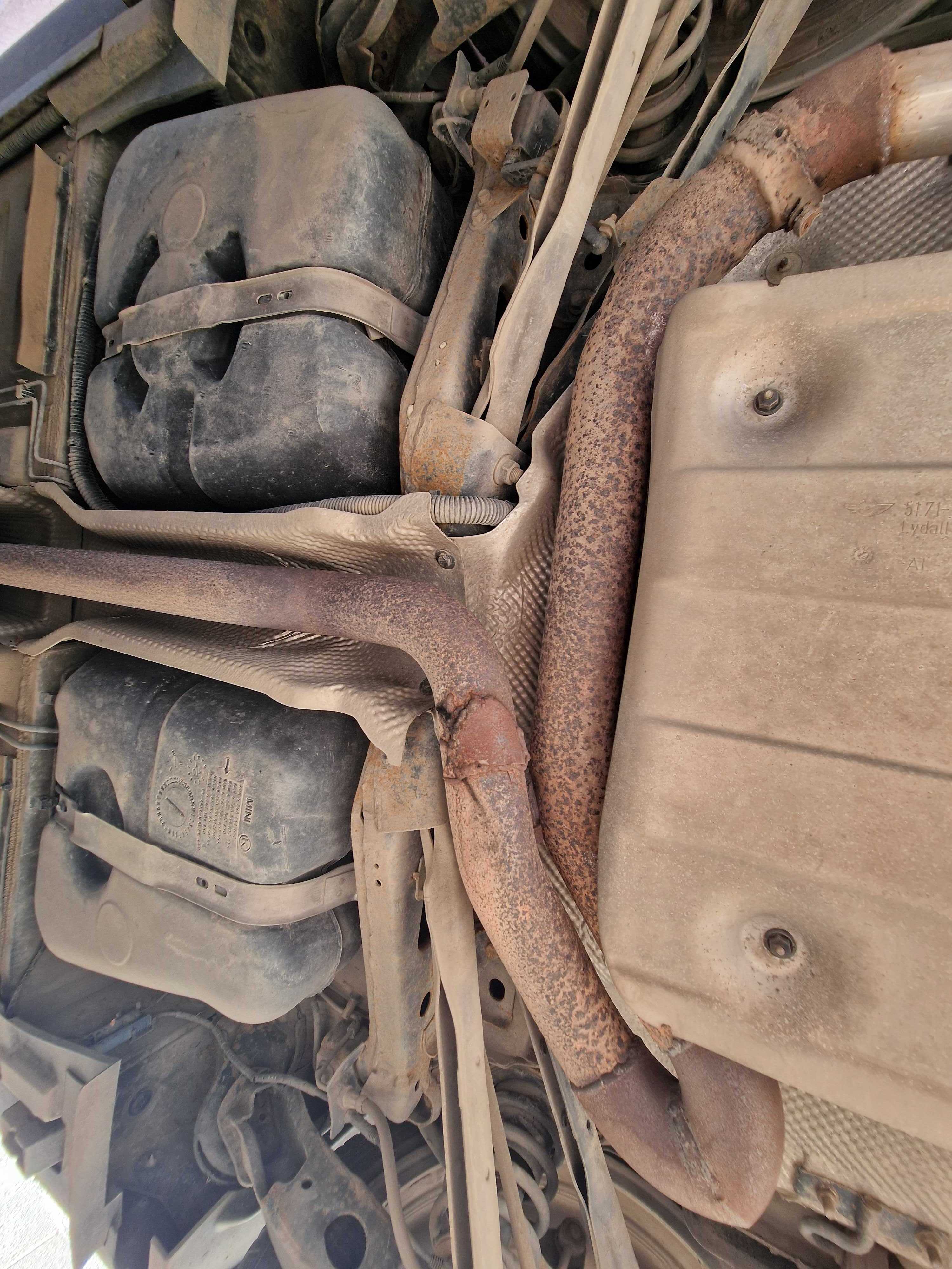

The previous owner cut the rear mufflers and the exhaust job is pretty bad since it has a 180 degree bend in it.
I will be doing the exhaust properly in the next few days but wondering if that could be the reason of power loss or it might be something with the engine?

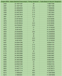

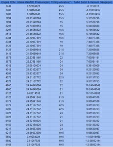

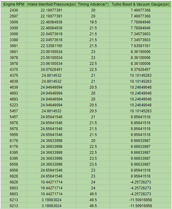

Here is a log i did with the Torque Pro app in 3rd gear, can someone check if the parameters seem ok or is there something wrong?
Also pic of the awful exhaust job.

Mileage? Compression/leak-down test? Have you checked for any code/s it may have thrown? If you don't have a reader, most auto parts stores will run a check for you at n/c.

170,000km (105,000mi) Compression is ideal on all 4cyl (dont remember exact figures) leak down test is yet to be done since i dont have a smoke machine but every hose seal and vacuum hase been checked and all seem good.
I have a basic OBD2 that was used for these logs and also have INPA, full scan with INPA multiple times and no codes appeared, only code was something for mixture too ritch when i got it but that was cleared and never came back afterwards.

Did you get the exhaust system changed? If so, did it help your problem? It's definitely going to diminish performance and is the most obvious problem.

Update!
Ok so just cut the exhaust off because i had some free time,
the exhaust was definitely a choke point and the car pulls a lot better, (still sounds like ****)
not certain its 100% good now, still can't hear the SC over the exhaust noise but the thing is really quick now.
