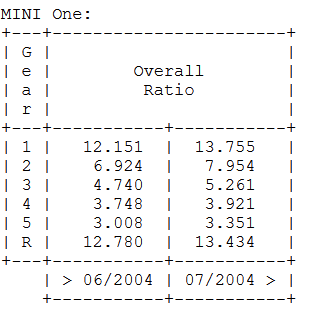

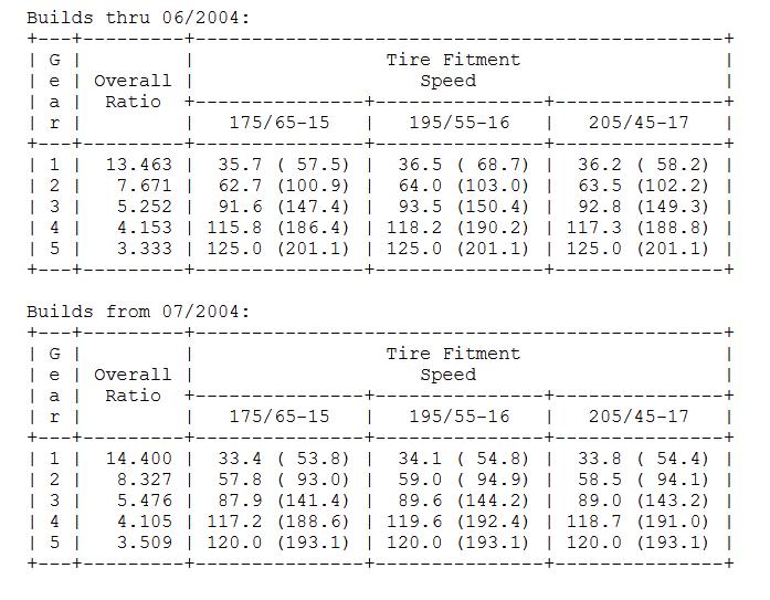

Here are the overall ratios and max speeds per gear and tire size as pulled from an old faq from another site. I don't recall ever hearing about an electronic limiter in the R53, so I assume the speeds listed in sixth are drag limited (but don't quote me on that).
And to answer your question, the facelift cars all have shorter ratios in every gear... except fourth gear and reverse (14.105 vs 14.065) in the R50. Also, the One and the Diesel have different ratios from the normal R50.
It's not particularly relevant to this discussion, but I might as well also add the R50 ratios.
I've already gone overboard, so might as well continue to overdo it. Here's the One.
And the Diesel.

The opposite is true if you look at the ratios deepgrey posted. Quick refresher: a larger overall ratio number means higher RPM for a particular vehicle speed and a smaller overall ratio number means a lower RPM for a particular vehicle speed.
(With that information, we can see the "tire fitment speed" numbers don't make any sense, but that's another discussion.)
PFL have "taller" gears (smaller ratio #s) overall. So there's lower RPM per mph for each gear compared to face lifted R53s.

@mrbean , what seems odd to you about the tire fitment speed? I didn't make those tables, but I get almost exactly the same numbers for the facelift R53 as that table shows, both for mph and kph.

@deepgrey I get almost the same numbers except for 6th gear (both pre and post facelift trannys) 264.6 kph and 252.7 kph,respectively.

Yes. I previously noted terminal velocity in the comment where I posted the tables. Whoever made them used what I assume is a quoted top speed since a stock R53 is incapable of running to redline in sixth.

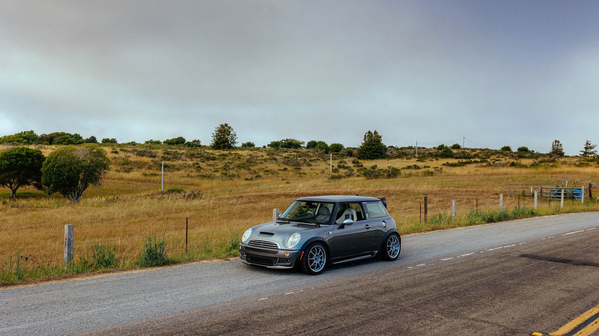

I can confirm that the PF Trans works in Facelift cars, and it works really good.
With a Tune (197 WHP/176TQ, stock injectors and 17% Reduction, DDM Sealed Intake, and MSD) I can quickly speed up from 60-90 MPH with ease. I have a spare head from a PF engine, and I am going to do some research to see if I can fit a PF head on a Facelift Block, and if so, will be going a Big Valve head with a big cam, and 550cc injectors. Aiming to get to 275 WHP.
I actually went further with installing a Coolerworx Shifter, and was able to utilize the facelift cables on the PF trans, and everything bunches up perfectly. I do not get any DME faults, or bugs according to INPA either.
I'll link some photos of the car for your viewing
