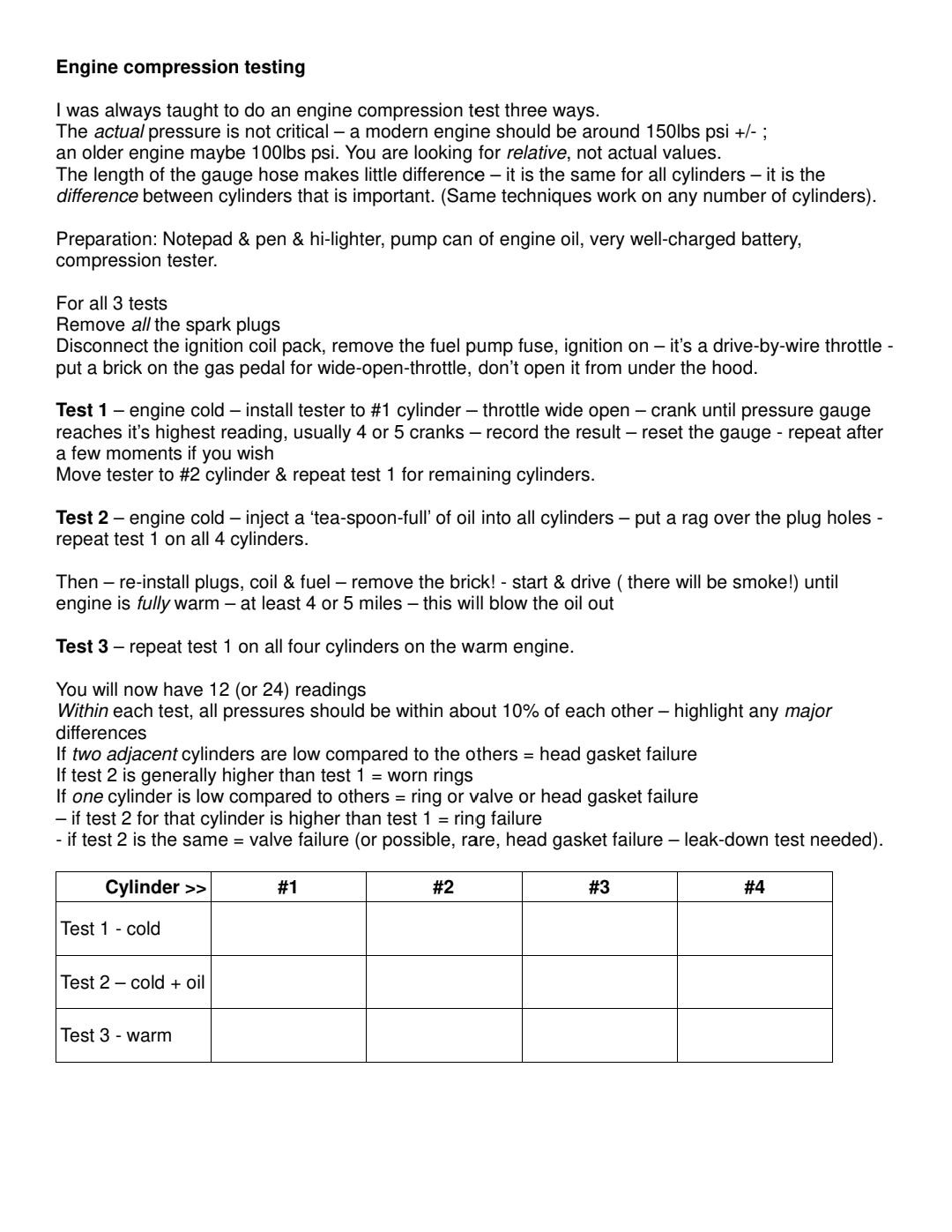

Although I agree with @mrbean , a leak down test is not something most DIYers can do themselves because of the need for an air compressor.
A long time ago I found this pdf file describing how to do a compression test (or rather 3) and how you should interpret the results. It has worked for me all those years so it might help you also.
Apparently I can't upload pdf files so here is a jpg instead.
Thank you for this! I didn't see it until after i was done for today. Definitely good to go by the next time i do this!
