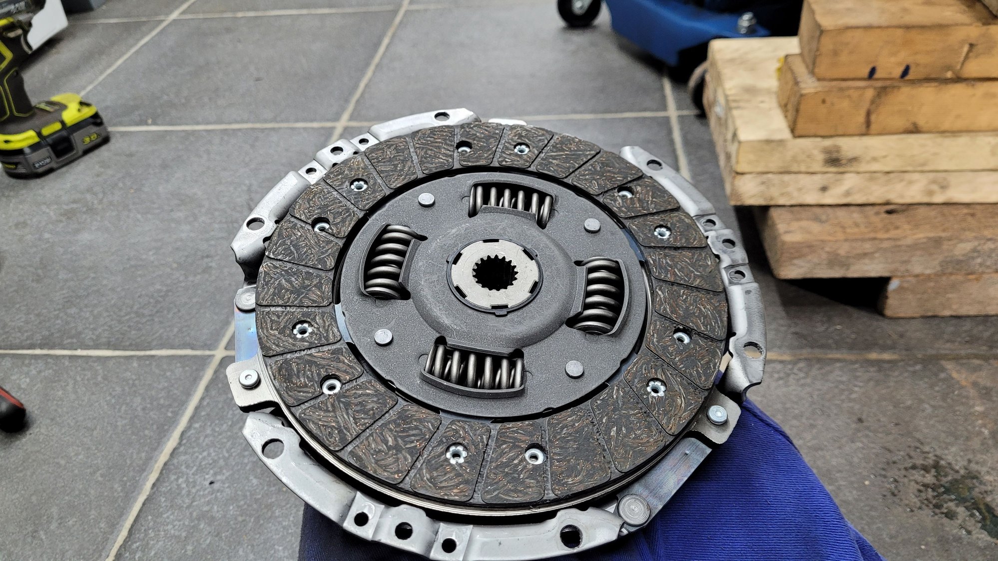

So I took the gearbox out. I was hoping to find something silly like putting the clutch in backwards. But unfortunately everything looked fine... Compared the clutch bearing/disc/housing and didn't find anything really. The design is definitely different compared to the LUK one but then again, a Valeo is also different compared to that.
So I made the not so fun decision to put the old clutch kit in, just to see if that resolved the issue. If not then I know the new clutch is fine and I need to look elsewhere. This does however mean I will have to pull the gearbox again...
Question: as I am looking to do as little work as possible, can I start the car and shift gears without putting the subframe and front end back on?
I think I can when putting the axels, gearlinkage and all electrics back in but then again, you never know if I overlooked something.
Nothing wrong here
Nothing wrong here
Clutch disc was not put in backwards
Bearings look very similar
Clutch housings do have a different design
This was the only question mark I had. The discs differ quite a lot in thickness. Not so much in clutch material but the new one is definitely sitting higher.

I think that last pic is telltale. Some diligent measuring is in order. Your symptoms sound like the clutch disk is not being released. Maybe even bolt the trans back up and use a borescope to watch pressure plate operation? That clutch disk difference looks very suspicious. I would prob call valeo tech supp first.
You cant change the position of the flywheel face, so I suspect that clutch disc is always contacting the flywheel.

do you still have the old flywheel or did you not replace that? If you still have it use it to take some measurements;
-measure from the back of the flywheel to the top of the tines on the pressure plate
-measure from face of the splines on the clutch disk to the top of the tines
-compare the measurements to stock
your new pressure plate looks like it is not self-adjusting, that means the tines will go closer to the flywheel as you tighten it down on the flywheel
someone can correct me if I'm wrong, the throw out bearing will be pushed up against the tines of the pressure plate when the trans is installed. If it's further back you may not get enough push from the slave to disengage the clutch disk.
about the clutch disk, if the face does not make contact with the pressure plate or the glide tube on the trans side, and does not make contact with the flywheel it should be good. Sounds like you are ok there. If not, you would hear it and see damage

You guys are right. After measuring the new clutch plate + cover and comparing it to the old the there is a +5mm difference. @ssoliman is on the money. If the look at the picture below you can see the gap at the clutch cover spring/flex part is larger. This would mean the travel distance is larger which the slave cylinder just can't cover. I wouldn't be surprised if this is the reason which my old slave cylinder failed; over stretching the rubber seal.
Left the old LUK, right the new MecArm (Italian clutch brand)

So I just bolted up the bare minimum to start it up with the old clutch in it and sure enough it shifts smoothly through all the gears. So it's not a badly bleed slave cylinder, it's not something I did wrong when rebuilding the gearbox with all new bearings.
It's the cheap ($70) MecArm clutch. For those in Europe NEVER BUY THE MecArm MK10190 even though TechDoc states it's the right one for your Mini R50 and the OE numbers match!
The question now is, do I buy a new LUK or Valeo one? I have the Valeo smf kit in my R53 but the LUK is the factory standard one.
