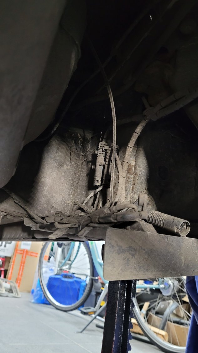

I also found a curious case of brakepadwear wires (see photo)
So someone ziptied the brakepadwearsensor to the back without it being plugged into the brakepad. The curious thing is that there is also an un plugged wire going to the actual brakepad. So essentially two breakpadwires but none of them could actually work

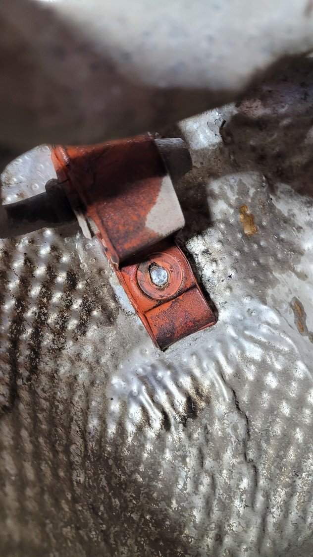

Look at the state of that. All hangers were like this.
My guess:
Here in NY the inspection requirements are to have a working brake wear sensor. Having one plugged in and zip tied out of the way tells the system that the pads are “OK”. Having one “plugged” into the pad but unplugged electrically shows the inspector that there is a “working” sensor. Not sure how that saved the previous owner any time or whatnot, but that would be my guess as to why you see what you do.

Originally Posted by Eddie07S
My guess:
That's exactly what I was thinking. I just don't understand why one would ziptie it away instead of properly connecting it.
Unless...maybe in the past it had brakepads without the wearsensor hole?

Or maybe they thought the wear sensor wore out too soon leaving “usable” pad behind. But that wouldn’t help with the inspection where the inspector should be looking at the pad. Just guessing here. I do agree, it is a bit strange.
In my case, I have them tied out of the way because I track a couple of my MINIs and I am wearing pads out in a few days. When not on the track I change the pads back to street pads, so I seeing them all of the time. That is actually how I found out about the NY state inspection law. One flunked. Not a big deal; zip ties are cheap.

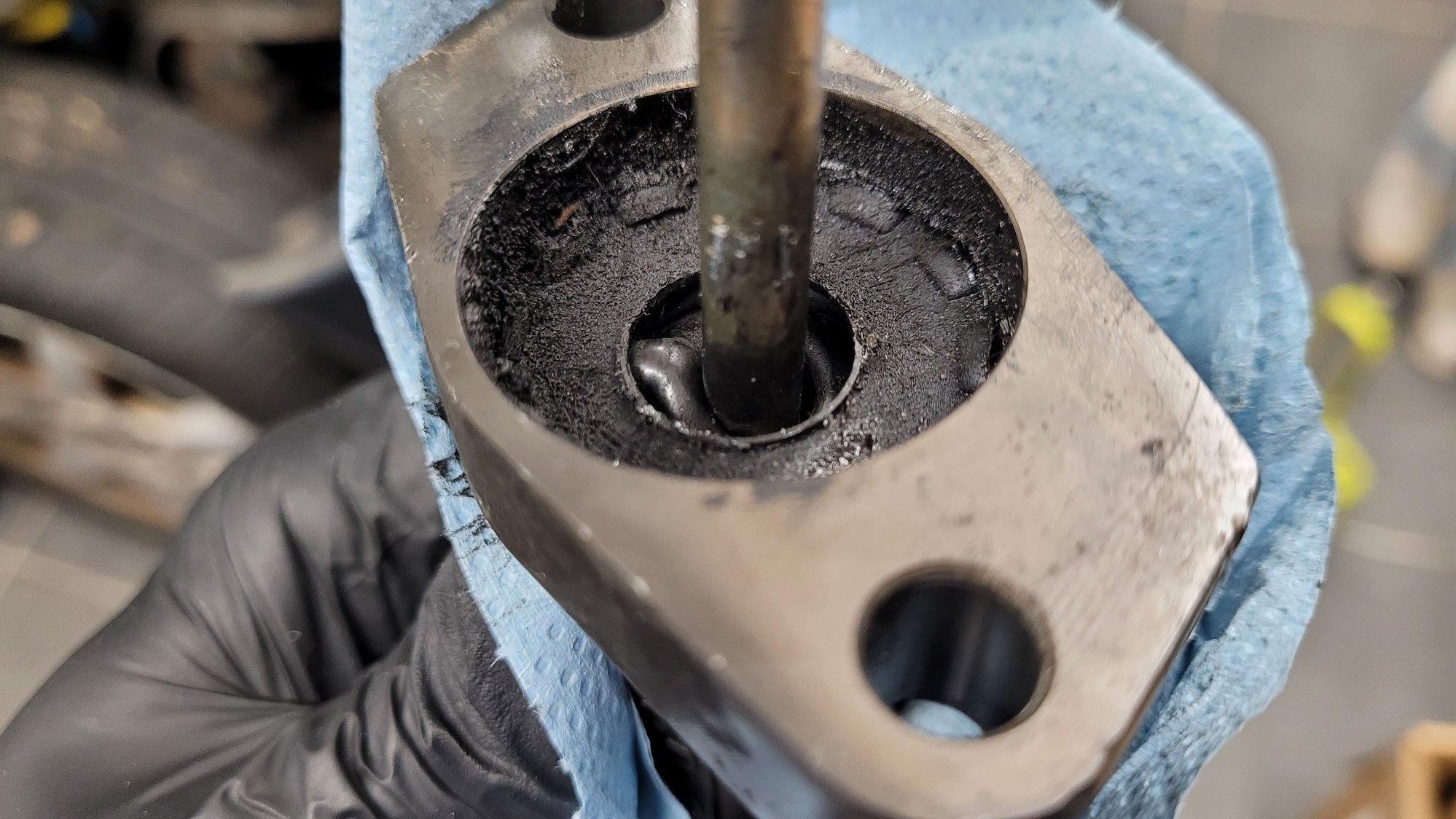

First let's drill the snapped stut out, with a pilot hole
Pilot hole, not 100% centered unfortunately
Now onto a 8mm bit
Looks good

Years ago I bought this box with exhaust hangers for r50 and r53 for just $30. It was from a local guy who worked at a BMW dealership. Good stuff and I can still use it every now and then
Hangers in and bolted up

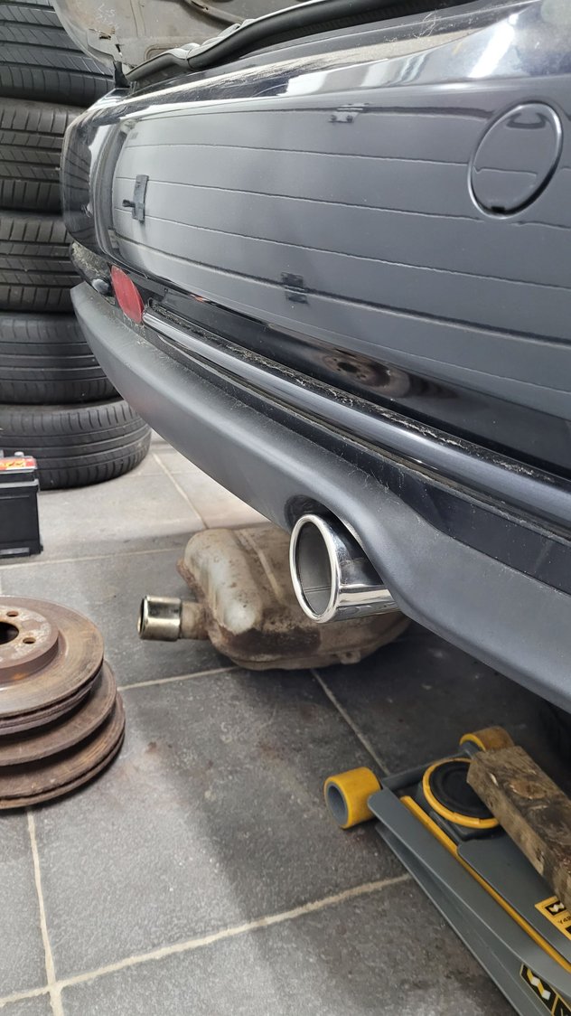

The exhaust, one piece from cat to the back
The part number is Walker 23066
Needs a tip right?
With tip, you can still see the original pipe
But only if you directly look into it

The pipe in the exhaust tip will darken up with time and you won’t be able to see it. It all looks good. Waiting for you to do a sound check.

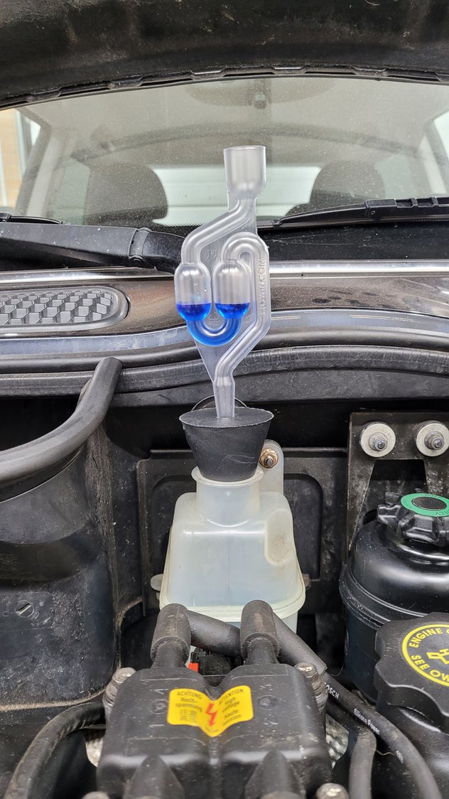

I'm still leaning towards a bleeding issue on this one, although the paddle feels normal.

As everything on this car, even replacing the slave cylinder was hell. Took me 2(!!!) hours. The steel line that bolts into the slave was a bit corroded, not surprising me. What made it hell was that the fitting that bolts into the slave was corroded stuck on the line and didn't want to turn without twisting the line.
​​​​​​At first I got the old slave off by rotating the slave instead of the fitting. Then I could work my magic to free up the fitting without breaking or bending the line. It eventually broke lose after spraying and moving it back and forth one millimeter at a time.
So I could finally fit the new slave but after all that work I didn't want to fill and bleed it only to find out it would leak. No photos today as I was that annoyed by what should have been an easy kob.
Next post will hopefully be about bleeding and being able to shift again!

And I bleed the system 4 or 5 times, pedal is hard after 5mm of play but still no go. I can force it into all gears but 1-5 are very stiff and reverse crunches.
Either that new cheap Italian clutch is faulty or I messed something up during the gearbox rebuild. I'm hoping the first as it does shift with engine off.
So I'm in for another gearbox removal, ugh.
I'm going to check if I didn't put the reverse idler gear shaft in backwards and change the clutch.
This is the old slave cylinder. Look closely near the shaft and you can see a bulge
From a different angle
