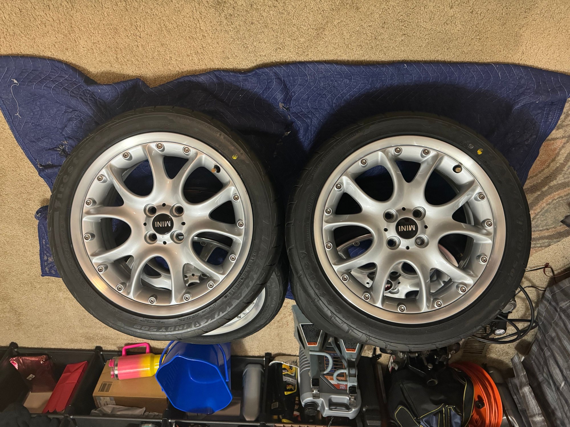

I got the RE71RSs slapped on this past weekend and gave them a break-in run. I can't make a full assessment based on this alone but initial impressions are that it's a very sticky tire with decent ride comfort and noise levels.
I was not impressed with overall steering feedback. They seemed to go numb on tight hairpins and the car felt a little weird accelerating out of high speed sweepers (it couldn't decide if it wanted to understeer, oversteer or 4 wheel drift - it sort of meandered between all three, not unsettled or unstable, just indecisive).
I also realized that switching over to white rims was a huge mistake. Here's 15 minutes of driving. Hawk HP+ pads have been on the car a while (now discontinued I think). They bite hard but makes lots of noise and dust.
