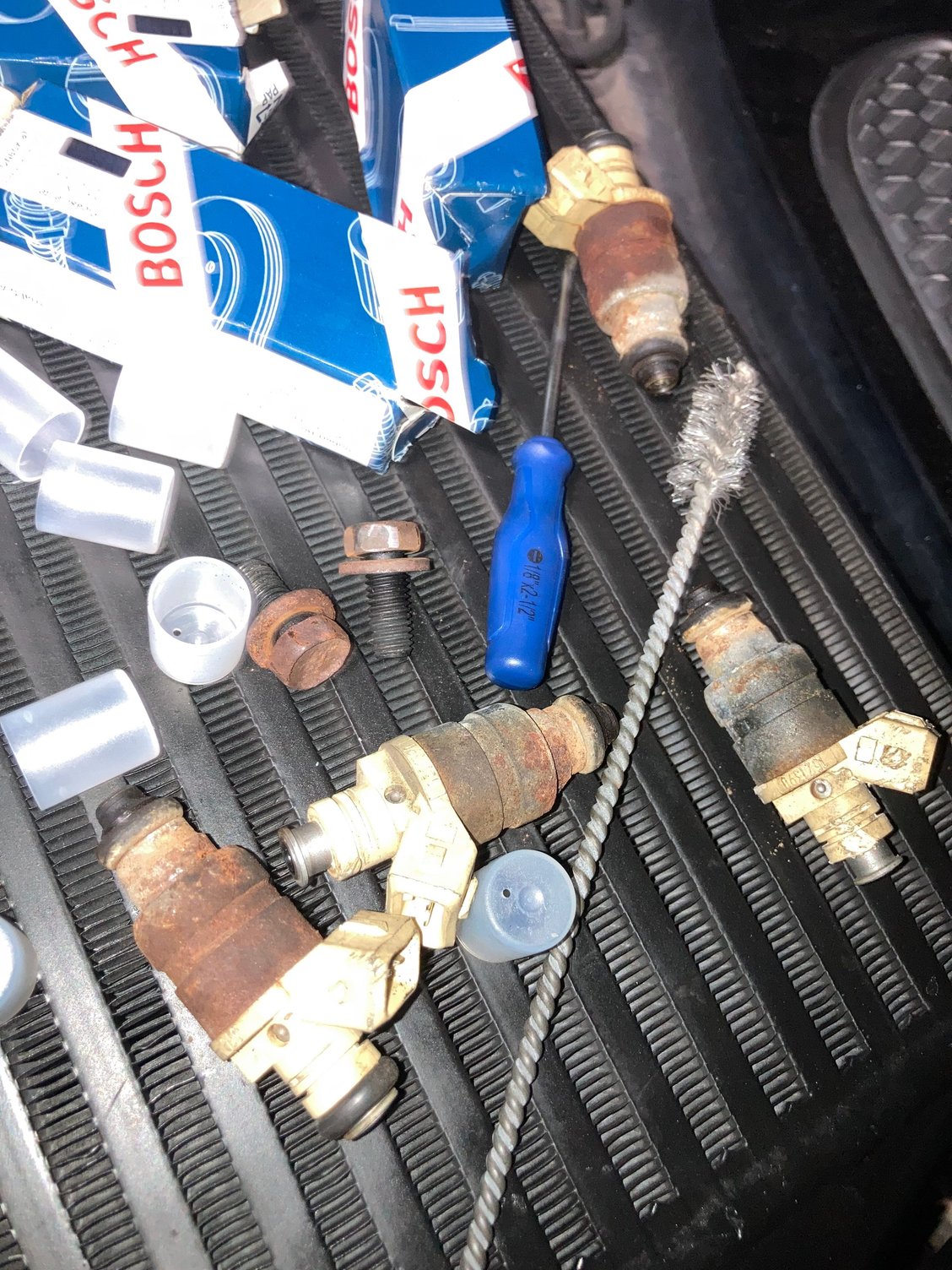

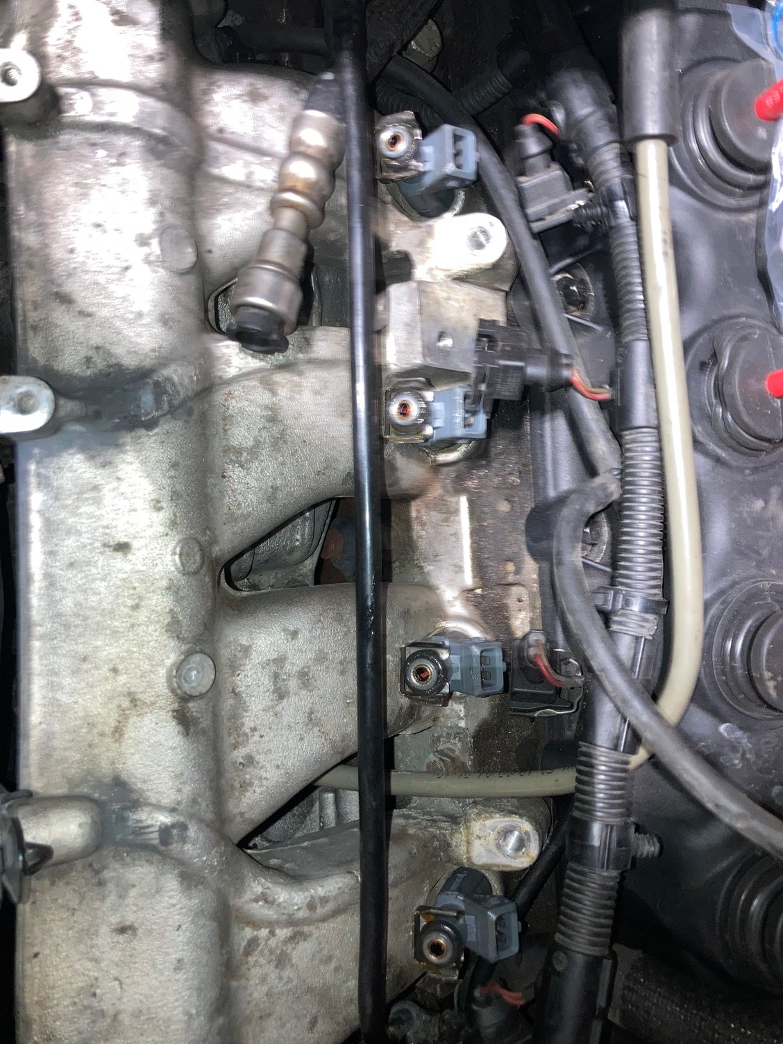

Okay so this is almost a two part thing. On my last thread I pointed out how I am only making 10 pounds of boost with a 15% pulley & 2% overdrive crank pulley. 10lbs on that setup is pretty low imo and I remember at least 6 months ago topping out at 15lbs of boost at WOT. Also I have been chasing a P1498 code (unmetered air after compressor) which I assume had something to do with this issue. I for the life of me could not find and loose, torn , or cracked vacuum hoses. A DIY smoke test turned up nothing also. Somewhere on an old thread someone mentioned their crank pulley degrading causing this issue but I threw out that possibility because I have never heard of an Alta pulley going bad. Someone commented on my last thread to grab ether based starter fluid and spray around looking for the leak. 2 cans of 50% ether starter fluid later and nothing caused a change in rpm on the vehicle. So now lets jump into what I did today which solved my issues (I HOPE). I bought a set of Audi injectors from FCP EURO which were recommended by AdrianCL (Sorry Im not as advanced as a-lot of other people on this forum so I don't know how to tag adrians username)

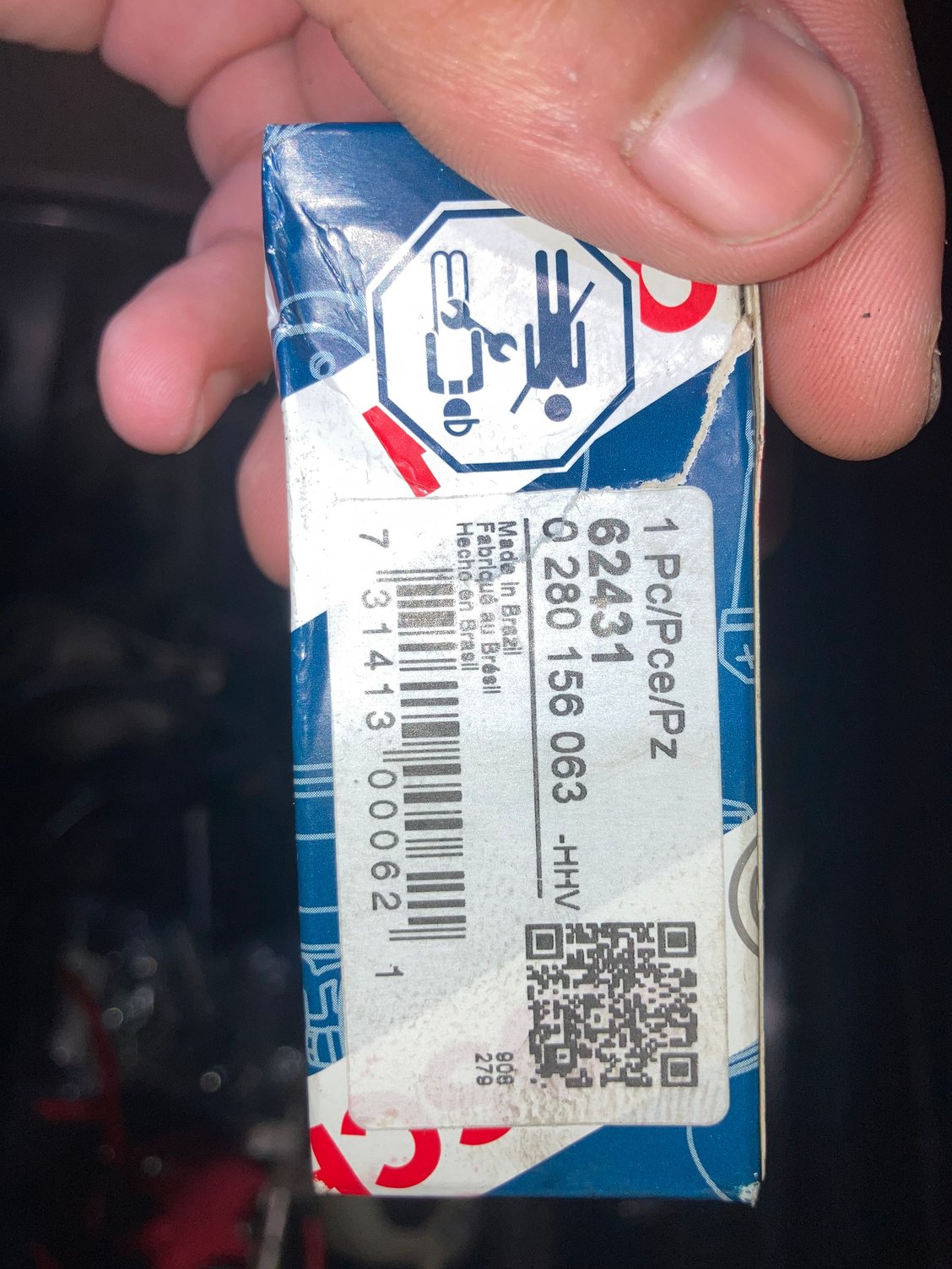

I will provide pictures of the injector part # so you can order. They are direct replacement plug and play and I think they are 375cc.
Okay so heres what I did. I replaced the injectors and while doing so checked alot of the vacuum lines. I also replaced the bypass valve which I believe to be the culprit in this situation. I replaced the bypass valve with a Detroit tuned one. My old one was very very easy to push in but it would also spring back. But what I think was happening is the bypass valve wasn't closing all the way and the engine was sucking in air through the bypass valve at low rpms and idle causing my “unmetered air after compressor” (the bypass valve is after the compressor). After the install and re assembly of everything and clearing the codes no more surging idle and no more CEL even after a hard drive.
THE BEST PART BEING THAT ON THAT DRIVE I PEAKED AT 15PSI AGAIN! I can tell the car will need a tune but the ecu can adjust for most of the fuel.

I bought a set of Audi injectors from FCP EURO which were recommended by AdrianCL, I will provide pictures of the injector part # so you can order. They are direct replacement plug and play and I think they are 375cc.
https://www.injectorplanet.com/produ...-06a906031bc-1
Yep just shy of 380cc, very good to know for replacing / fitting unobtanium JCW spec injectors. Thanks for sharing!

Direct replacement 375cc injectors
Heres the link to fcp euro for the injector kit I used.

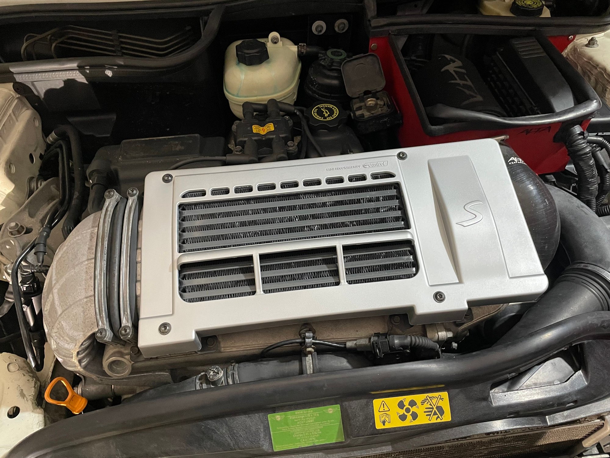

He will be tuning it very soon. I am going to do the 19% pulley that I have from WMW and I do have an Alta air intake. It has a box around it but im not sure how well it seals.

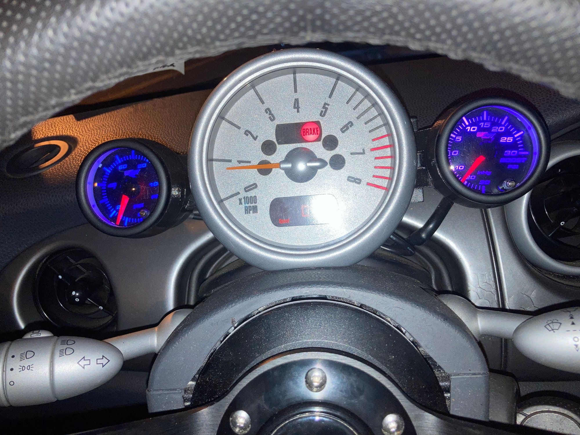

I must've misunderstood you in your previous discussion/thread - I was under the impression that you were gaugeless.
Those gauges look mighty cool I should say!
