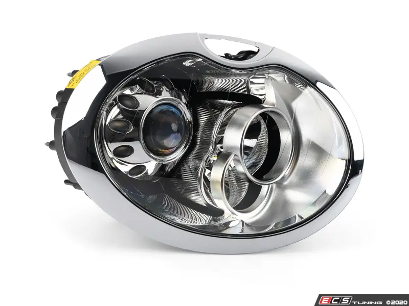

People swap to the Facelift Xenons, they are much better. I have them. If you have Xenons factory pre 7/2004, its a straight swap with new ballast and bulbs for the 7/2004+, so new Xenons
Facelift.

For people that have 7/2004+ Xenon's factory (mine had a ton of miles), most will need new bulbs (old ones look pinkish and maybe a ballast if flickering. You will also need to polish the headlight

Just an addendum to myself and for others who might be wondering or intending to do the swap with a pair of preowned or salvage yard facelift projectors.
While the early/pre -facelift ballasts and the facelift projector ballasts are identical and interchangeable - In contrast to that; The pre-facelift HID Xenon low beam and facelift projector igniters are not.
The low beam igniters and bulbs are completely different. In either case ridiculously expensive.
To the OP's original question and point - I also discovered how degraded (crumbly), the wires had become in the (original) OEM facelift projector igniter connector "harness".
I find it amazing that the original OEM pre-facelift (non projector) wires are so much more robust than the updated version. What kind of sense does that make??? (-$$$)
Therefore - It appears to me that in order to replace/repair these wires will require complete disassembly of the headlight housing.
Not something most of us look forward to.
