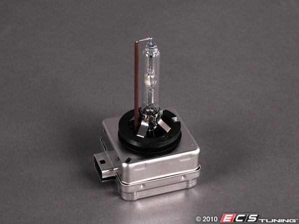

You will need the xenon control units ( ballast ) as they don't come with the headlights, they hook into the bottom plug on the headlights, the one with the two square plugs.
Xenon Control Unit - Priced Each ( one for each headlight )
http://www.ecstuning.com/Search/SiteSearch/63117356250/ES2590569/
The headlight show they don't come with the xenon bulb either. Part number 63217217509 x 2 ( one for each headlight )
http://www.ecstuning.com/Search/SiteSearch/63217217509/
& we carry the ziza ones also. They are at the bottom D1S Gas bulbs. Which bulbs have universal classification like H8 , DS1 , etc. So all D1S bulbs will work.
