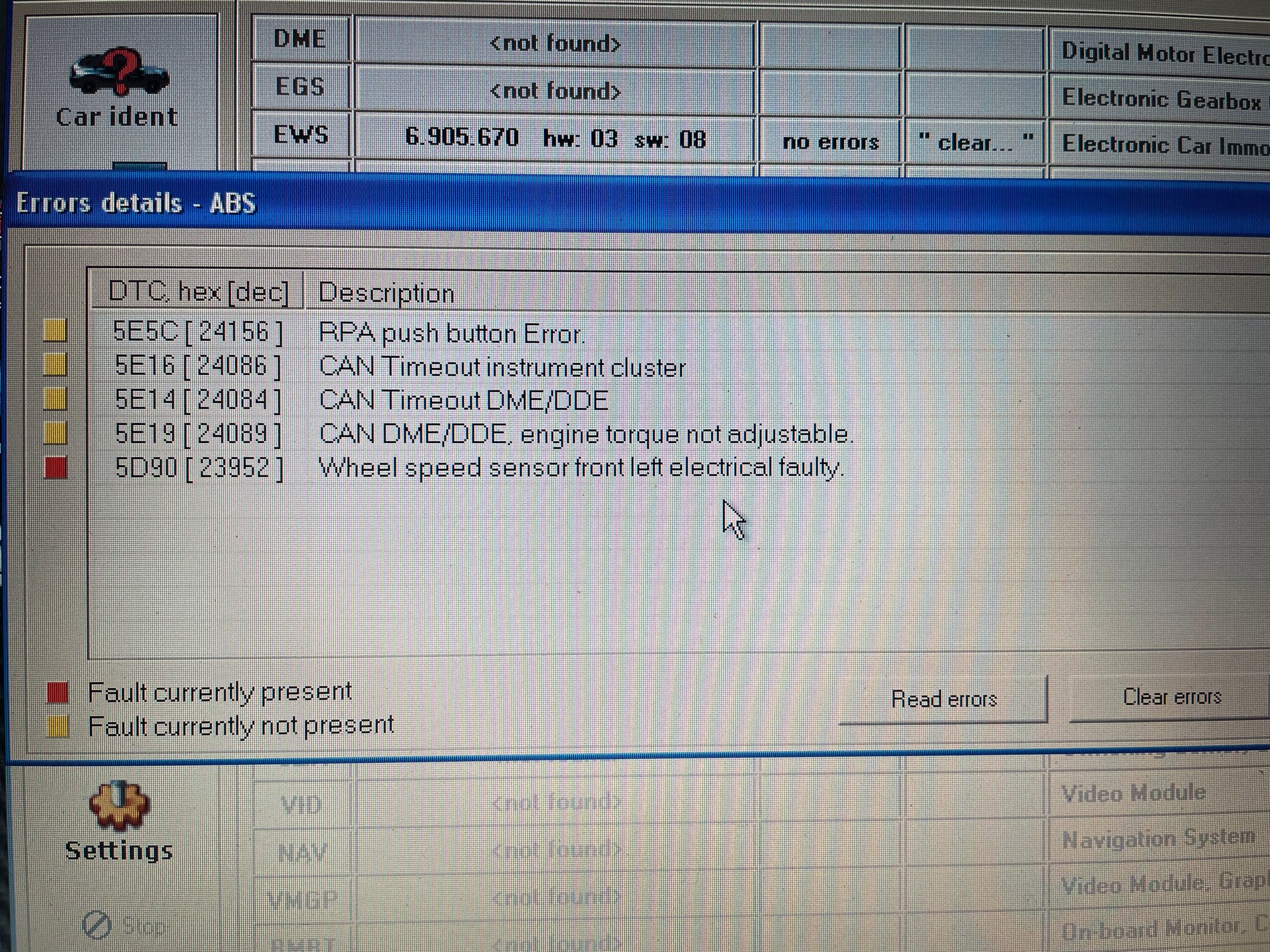

BMW scanner 1.4 is about $20 with cable and I have used it on the r53 parts/donor car to determine what caused the ABS light on it… just need an old laptop that has windows Xp or similar. I also have bmw DIS on that same laptop with inpa cable and switched it to the Mini version.
Between the two you’d be pretty covered.
and then you can add NCSexpert amd NCS for dummies and do your own settings, drl on/off, auto lock. On/off, comfort opening and closing, unlock with ignition off, and all the other sundry things you can activate and deactivate to your personal taste!
