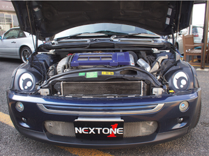

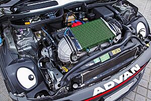

Nothing of value to add from me except to say that I can totally relate to the heart over head thing.
They say that the definition of romanticism is the triumph of emotion over intellect --- sometimes that's a very grand thing, and sometimes it ain't.
These cars are maintenance-heavy in my opinion, but the reward is worth it to me.
I'd love to see you buy it and kit it out with a smorgasbord of JDM stuff as it would be highly unique, hell, it may already have some choice bits already fitted?
Would be fun to see here in North America!
