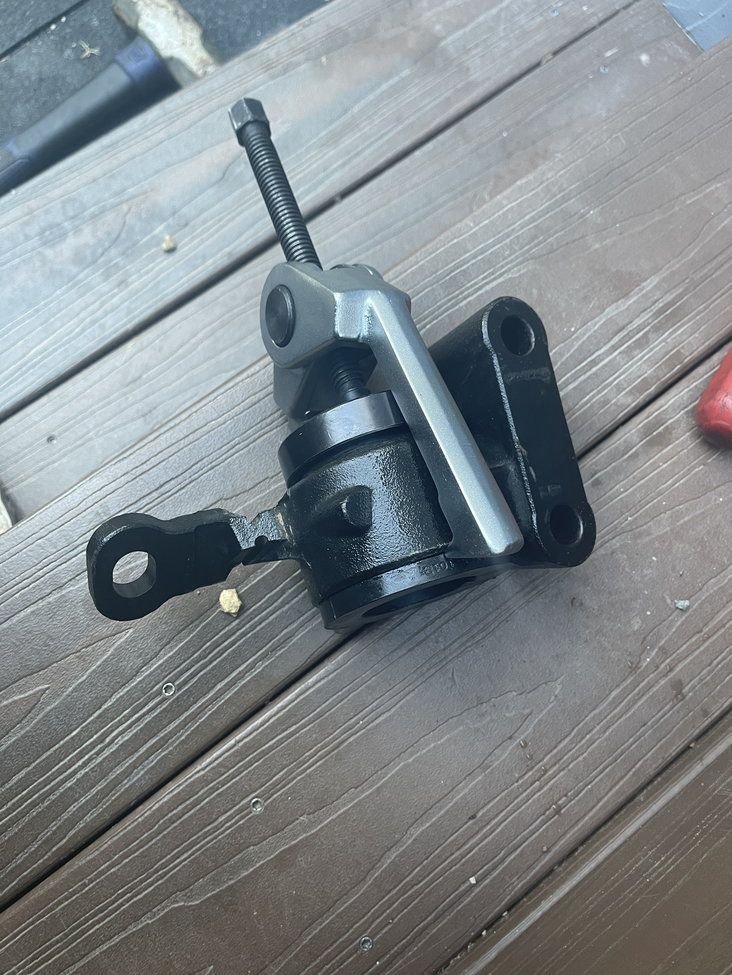

Welp, I got one off using the same threaded rod, nuts & large washers, along with a perfectly sized piece of PVC for a sleeve. All this wasted time...
I ended up checking PSB and Power Flex's diagrams. As it turns out I should get more sleep, I had installed them correctly, with the insert flat against the washer on the arm. But I swear on PSB's site they said to "have the smallest red area facing the arm."
Hopefully, someone will Google how to remove polyurethane lower control arm bushings and find this. The threaded stock, washers, and nuts method is effective.
Thanks @deepgrey and NAM for always helping a brotha aht!

Okay, so all front bushings, ball joints, and problematic gaskets on the engine have been replaced along with a few hoses. After getting the subframe back under the car I noticed that my driver's side bushing differed from the passenger side.
Just held the measurement tool up for representative purposes. Also, I never noticed this on the Powerflex bushings, but the washer is loose and can be slid back and forth.
I'm not sure if this is normal, maybe someone can clarify.

Are you saying that the black bushings are different side-to-side? I can’t quite tell what I’m seeing in the photos. They should be identical or close to it though.
I don’t remember for sure how my powerflex washers are, but I want to say that they’re pretty snug.

The black bushings are identical.
It's the washers I'm worried about, they can slide back and forth on both sides. There's close to the same amount of play in both.
I want to say that I remember from a few years ago someone posted that when installing the poly bushings you should measure something or another... I've looked for the post in the PF bushing install how-to's and haven't found anything.
I'm probably over thinking this... just want to get the MINI back to 100%.

I want to say you're overthinking it. There shouldn't be much load on those bushing in that direction. Most of the load, if not all, is radial load as the control arm goes up and down.
