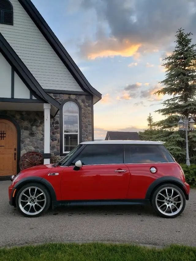

Hello! Just picked up an R53 JCW (210hp) mini last night. Man, so excited! Reminds me of my MkII GTI I had as a teenager.
My car has a couple things to work through but is generally in very good shape.
I'd like to start by asking for opinions on tire/wheel size. My mini came with 15" winters which are great but it also came with some 18" summer wheels with very worn tires. I need new summer tires which has me pondering the following:
1) do I really want 18s ?
2) are the 18s I have rare and valuable (more on this below)
3) should I trade the 18s for OEM 17" S-spokes
Ok so the wheels my car came with have a JCW logo on the centre caps. I found them on this site and they appear to be the R105 JCW double-spoke and weigh 23 lbs (less than the 17 S-spokes). Are these rare wheels? Sought after? Good?
I found someone selling some 17" OEM S-spokes and my first thought was "should I offer to trade". Being new to Mini, the S-spokes look great to me now but I wonder if they are so common that I'll get bored of them and wished I just sold the 18s and spent the money on something else OR, kept the 18s and rocked em.
Just looking for thoughts/opinions on the matter. Thanks!

First off, welcome to NAM and congrats on scoring that nice R53 JCW!
Agreed, those appear to be OEM R105 wheels per LoM's wheel guide (shown prox 2/3 down in 18" section here).
Downside of 18" of course is even lower profile sidewall with corresponding ride harshness. From your single pic, those look in very nice condition. If were mine and if pristine with desirable tires (runflats or not?), I'd consider picking up a set of 17" if found at a good price while you evaluate long term acceptability on what you have mounted now. My car came with (2) sets of the common OEM 17" R85 "S-Lites" (not-so-lites) plus mounted Team Dynamics 17" as required to clear AP Racing calipers, now in combo with Mich PS4S 215/45R17 (+1 size) tires which provide a bit more ground clearance plus air volume than OEM 205/45R17 size tires and works quite well with my modded suspension.
Please tell us more about known history plus details and pics on your car!

Keeping the 18s while I evaluate is probably the right thing to do. After having just bought the car I want to spend a bit of time/money on a few things and was wanting to avoid shelling out for a third set of wheels. I'm not in a panic to get summer tires right now so I suppose I can defer this decision. Thanks @MCS4FUN
Especially for long term resale value for the originality to the car and the desirability of those rims.
Plus, you know, they do look sharp.

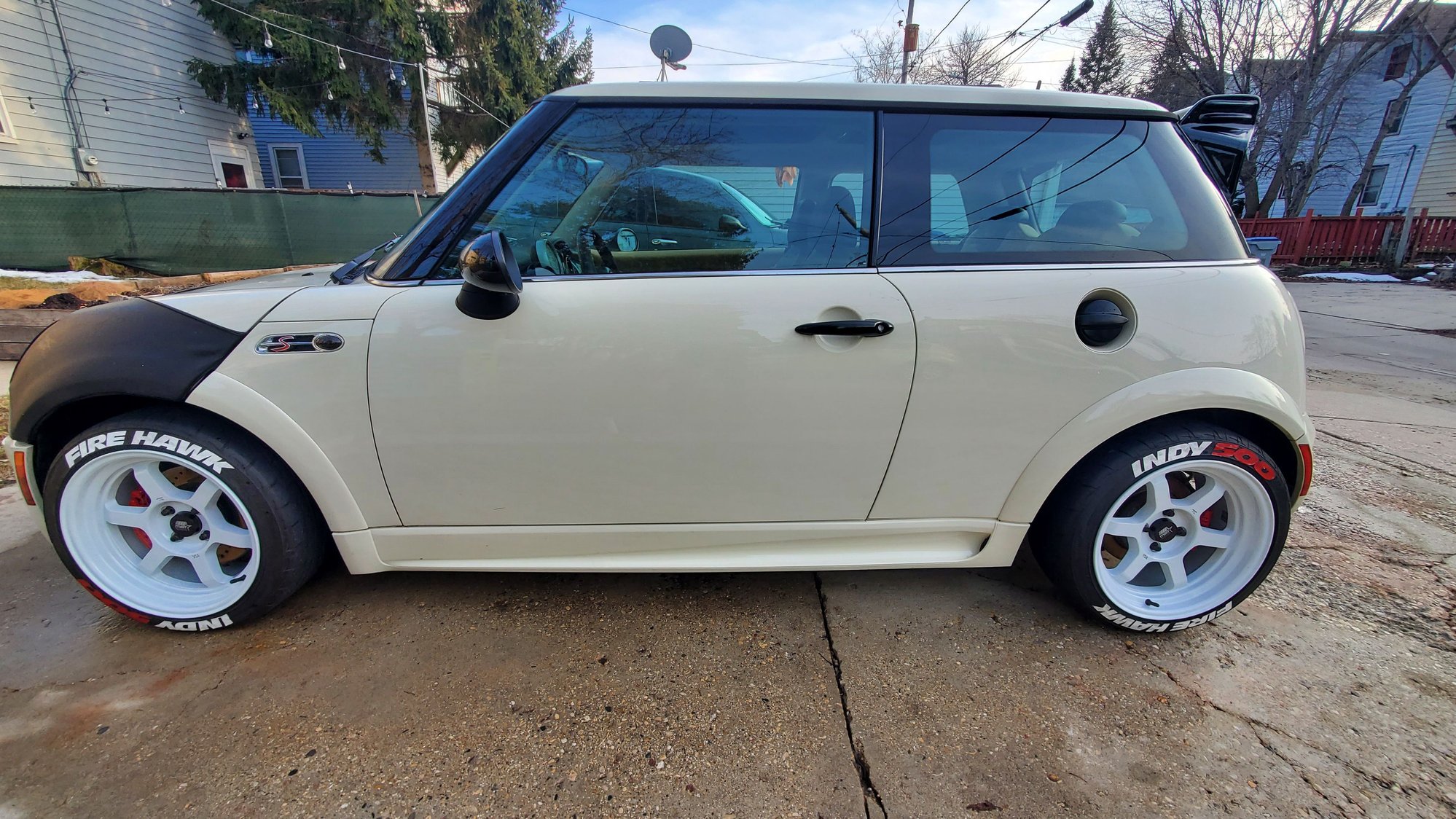

I prefer 15s because imo the car likes the smaller ,lighter wheels.. it helps acceleration ALOT actually.. I'm running mts 16x8 time attacks on my track car ( currently on the daily driver ) and mts 15x8 mt04 with just some ebay " performance " tires just because the tires have good looking tread pattern and protect from curbrash.. the black 15in mt04's and new tires should be here anyday then they go into my white mini and those white rims back onto the track toy mini.
Imo , these cars look best with a lipped rim and a chunkier tire. Btw , my mst 16s are 16lb and the 15in are 14lb only

Nice looking rides! Those 16x8 time attacks.... they speak to me. What offset and tire size are you running @MiniManAdam ? spacers? longer studs?
I'm looking to run stock r56 brakes up front which I don't imagine should be a problem with 16s ?
et20 and I run a 5mm spacer but I have widebody flares.. they clear my r56 brakes no problem. They fit with stock lugs n brakes ect but I do run extended lugs on my fun mini.
My tires on the time attacks are indy firehawk 500s 205/45zr16..
