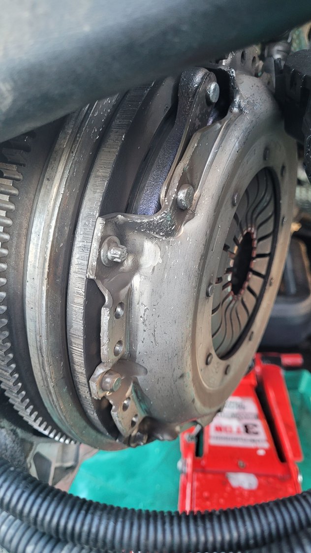

Took the transmission out. When I spin the shaft the differential spins where the axles connect, so I don't think the transmission is the problem. There were some large black metal pieces in the bellowing which is suspicious... it's been making the standard dual mass flywheel chatter since I bought it 8000 miles ago, any chance that the flywheel is broken? The clutch didn't look too bad either (forgot to take pictures)... don't know what the issue could be and I'm fearing it's crankshaft (though you'd think it would run poorly if this was the case right??).
With another brand of car I vaguely recall some owners experiencing problems with the dual mass flywheel. A "clunk" upon taking from a stop was one sign the flywheel was bad.
You have the transmission out but you ain't done yet. You need to remove the clutch and expose all its innards for close inspection and possible replacement. If nothing else this would fall under the while you are there rule...
And you must also give the dual mass flywheel a good going over.

Agreed. Clutch itself looks fine... waiting for the time to fashion a flywheel lock and then I'll pull thay out too. The throw out bearing sort of looks like the splines have been grinded down, but maybe that's just how they look? Also, I've figured out that this is an aftermarket LUK kit that the previous owner must have installed.
