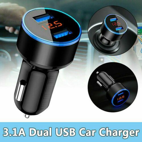

The light just measures the voltage in the charging circuit. It sounds like your alternator is failing. You'll find one of these useful:
Volt meter

Thanks, I'll grab one. What I find odd is it appears to be weather dependent. Things do contract in the cold though so if there's a failed contact somewhere it could be bridging the gap on and off.
