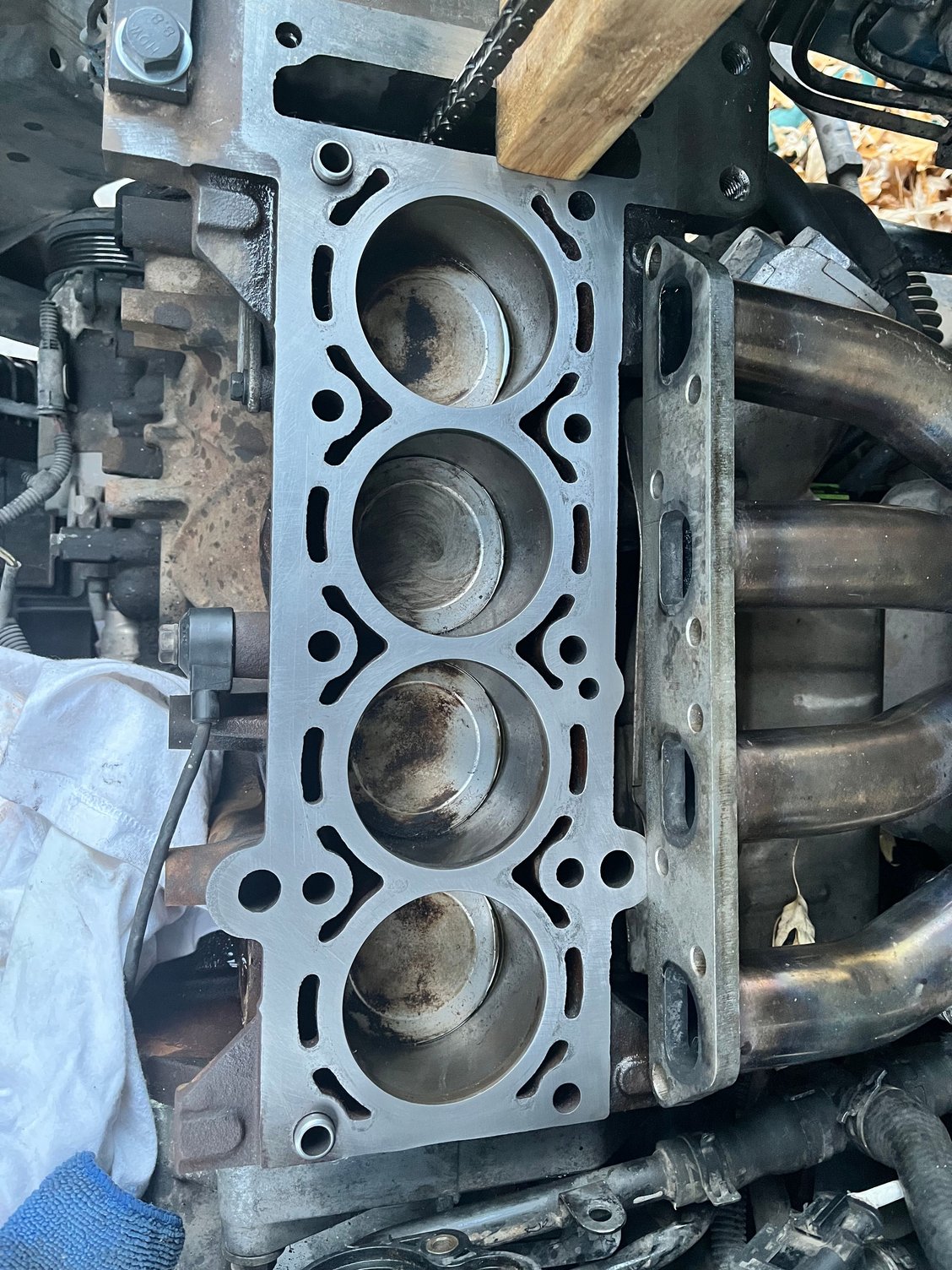

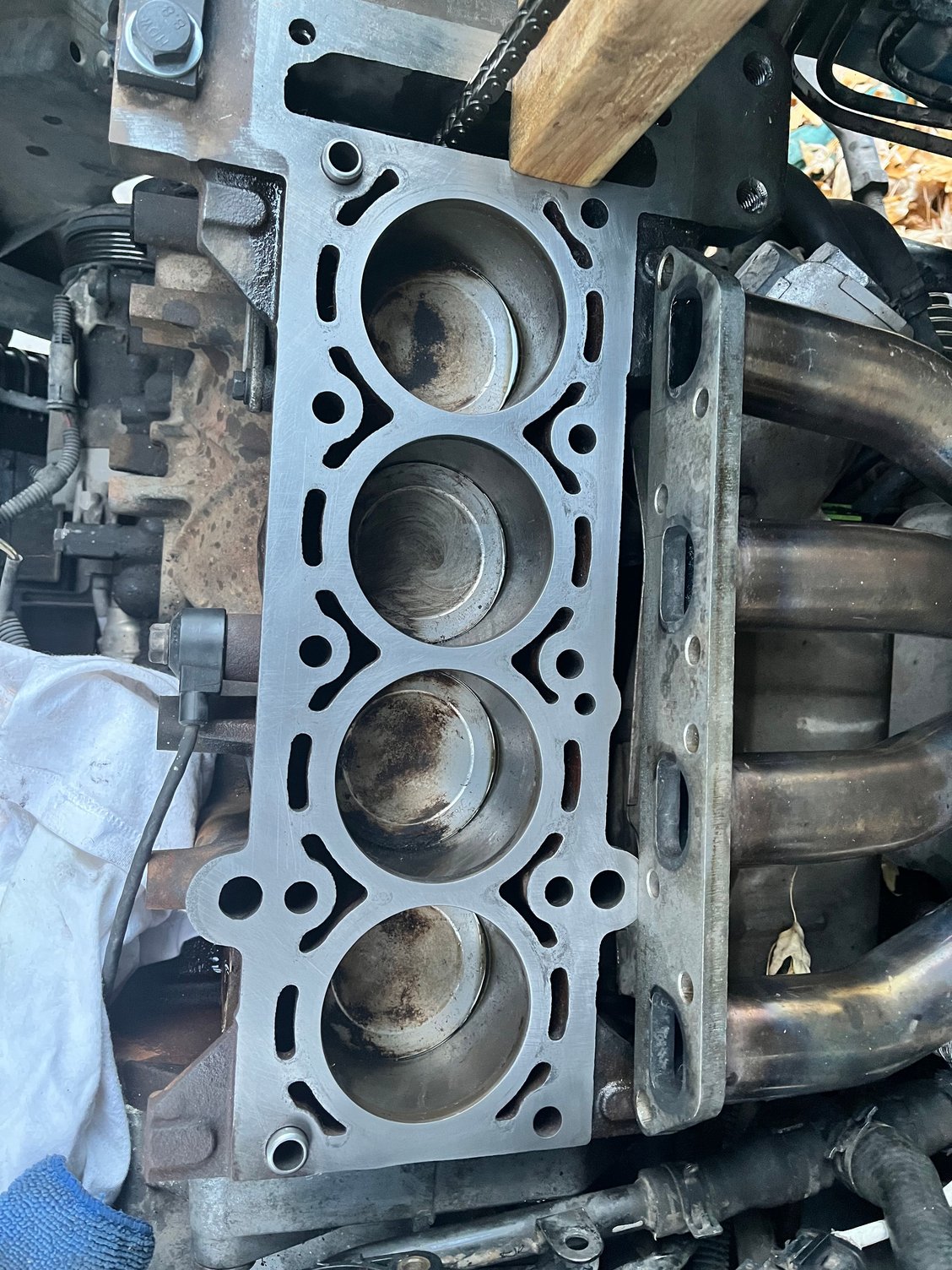

So, here is the top of my block. I ran a hone over it (90 degree crosshatch pattern) then hit it w wire brush. Moved to sanding block w 320 (plus wd 40). Finished w red scotch bright pad. I don’t think I can do any more with it. The places where you still see dark spots (near water jackets) are extremely shallow areas of pitting. I can just barely even feel them, but the game is measured in thousandths.
so what are the thoughts about copper spray? I have seen and read that it is NOT recommended for modern viton coated gaskets but I’ve read posts from people on this sight that supports using it.
I have a new viton coated gasket in the garage. Should I just slap it on and torque it down? Add the spray? Or source a non coated gasket and use that w spray?
let the debate begin!!
If you're asking me, you're gonna get more questions than answers. I'm not an expert. I'm also not a fan of tearing things down twice. What's your ratio of tolerance for pain to budget?
I'd be concerned that would leak and I'd, be tearing it down again, and, then pulling it to get it machined. You can tell from my "while I'm at it" list that I don't have a lot of hope in things going my way. I bought a new short block rather than replace a rod bearing because I expect to be unlucky. I'd pull the engine and get it to a machine shop.

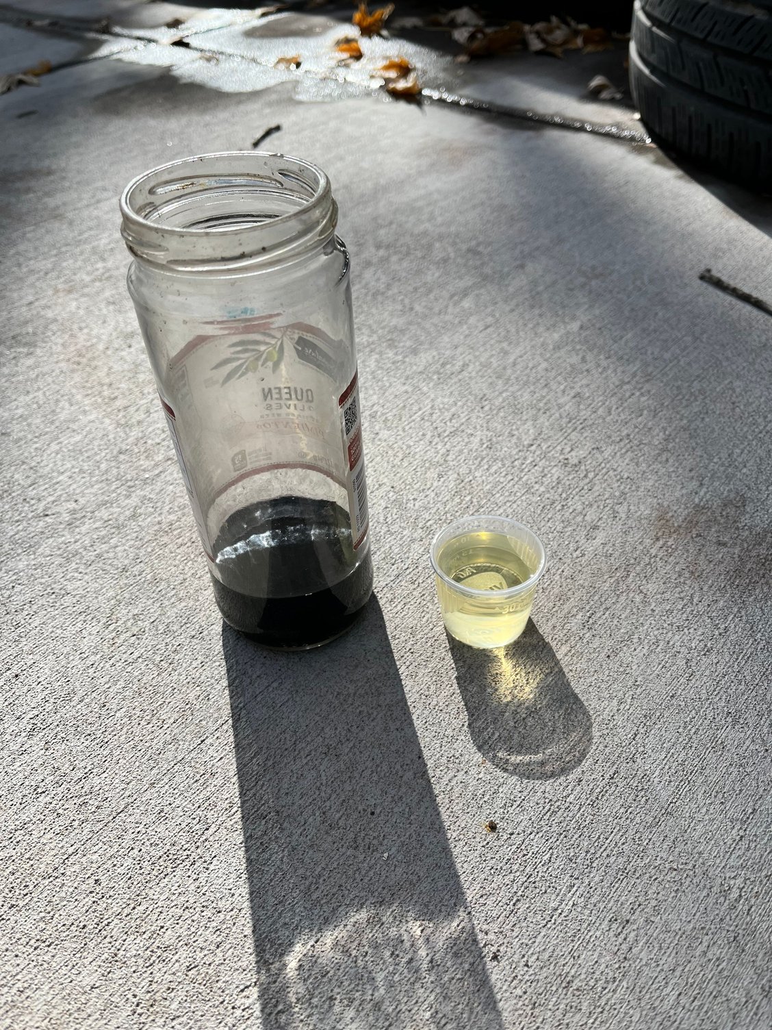

Well, another “while I’m at it” item for the list when you’re doing a HG; CHANGE YOUR SC OIL!
Ordered a couple of bottles from Amazon so I could freshen up the oil. Front oil was nasty. Rear was empty! Car has 115 k. Doubt it’s ever been serviced
