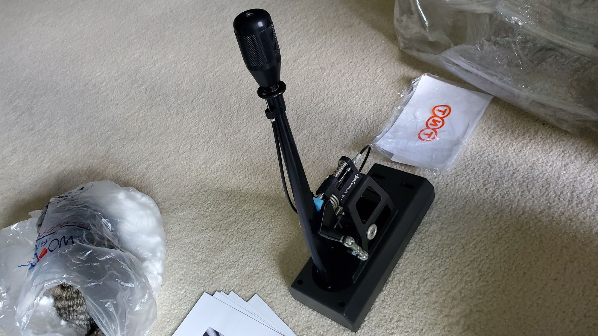

So I'm close to pulling the trigger on a coolerworx shifter finally but I have a few questions for those who have one..
I'm concerned the throws are too short , if they're about half of stock that'd be fine but if they're really short idk if I will like it. I do like SOME throw between shifts because imo it helps me locate gears better during fast aggressive shifts..
That brings me to my other question. How firm are they ? Will it hold upto a good,hard,2nd gear slam ?? Or will it cause issues or bushing stress over time ?
Now an installation question. Since my car is a pre-facelift do i need to purchase face-lift shifting cable or are my pre cables fine ?
last question, do you have a coolerworx your willing to sell rite now , if so ille purchase it now !
Thx for any help you guys can provide me with this...

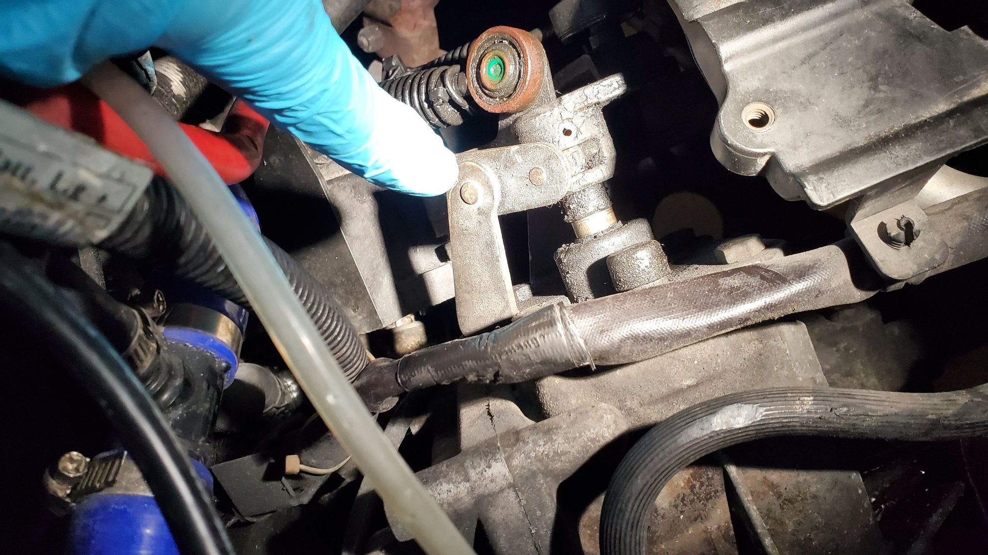

Soooooo can anyone explain my issue you could say I ran into.
sooooooo upon further inspection my car HAS to have facelift cables on it already BUUUUT how could that be possible wgen my shifter box has a sticker on it from 02' lol my car is an 04'.. do you think someone kinda hodge-podged pieces together when they put in the different engine n trans ?? How odd....I'm not complaining though because that's almost 200 saved sending the ones back to partsgeek . And about those THEY DO NOT FIT , THEY ARE EACH ABOUT 2FT TOO LONG !!!! can you 2x check the parts # to see what they're supposed to go to , my guess is the 4dr r56s or the countryman or one that is abit longer where it would have the shifter sit back further..I WAS going to just install tge cables to have new shift cables but yeah can't do that buuuuut thank GOOOOOOD p.o put facelift cables on...
anyways with getting the sifter in , I had to disassemble it abit. I had to remive the chrome adjustment rod AND the top attachment fir it , I also had to dremmel my shift tunnel abit then to clear the bottom connector of that adjustment rod. But I got the cables all hooked up and the shifter mounted. Tomorrow I'm going to have my buddy help me get the set screws it to get the engagements correct and reverse lockout setup. I will also cut my center counsel up to get it to fit around the coolerworx and once the vanity cover arrives that will be the final touch.. here's a peek at progress..
I also found this thing on the trans im pointing at. It's a bracket , i need a new one as mine seems to have excess play I the little notch that presses and engages. It'd held in with a rivet it looks like and if I get that good with this new shifter and I cleaned up n greased my cables , all should be smooth ! Anyone have a lead on this part ???
