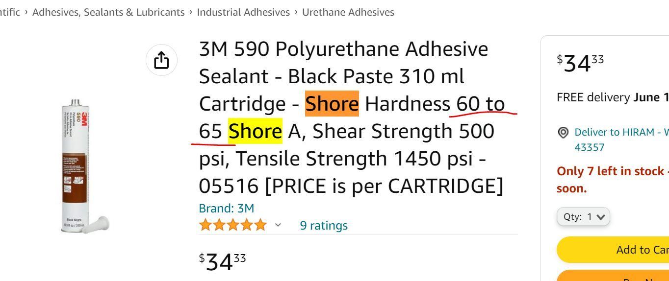

It's not so much the cost as the man hours involved. Yes, I had seen window polyurethane used (3M, 30$), this is just a vid of the process. Durometers are cheap so one could measure the shore hardness of a cured roofing/window polyurethane sample I suppose. Most polyurethanes I've come across are still harder than bushing rubber tbh. The idea's to get close to OEM and/or slightly higher stiffness to avoid replacement more than anything.
The only pitfall I can see is getting the indexing of the bushing just right. It looks to me like the bushing's dead center and not offset. If the bushing's badly damaged, it may prove challenging floating the sleeve inside just right. Might need to use a jack or c-clamps.
edit:
Looks like it's all online and the roofing stuff isn't as hard as bushing rubber while the 3M window stuff may be
