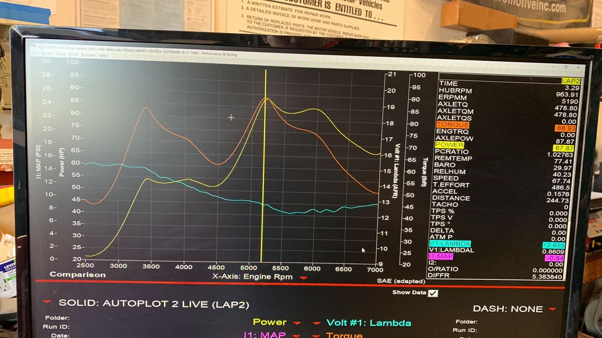

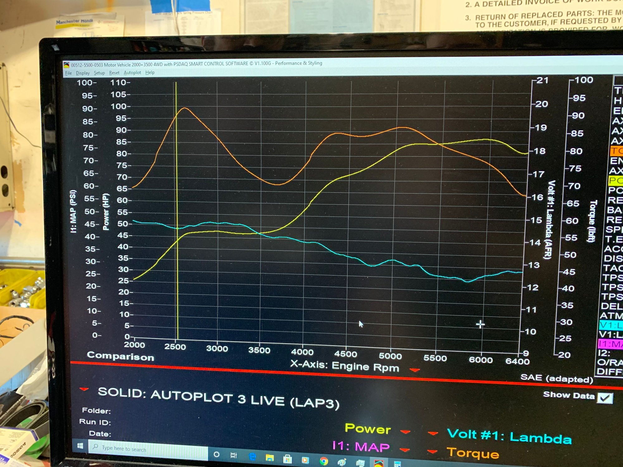

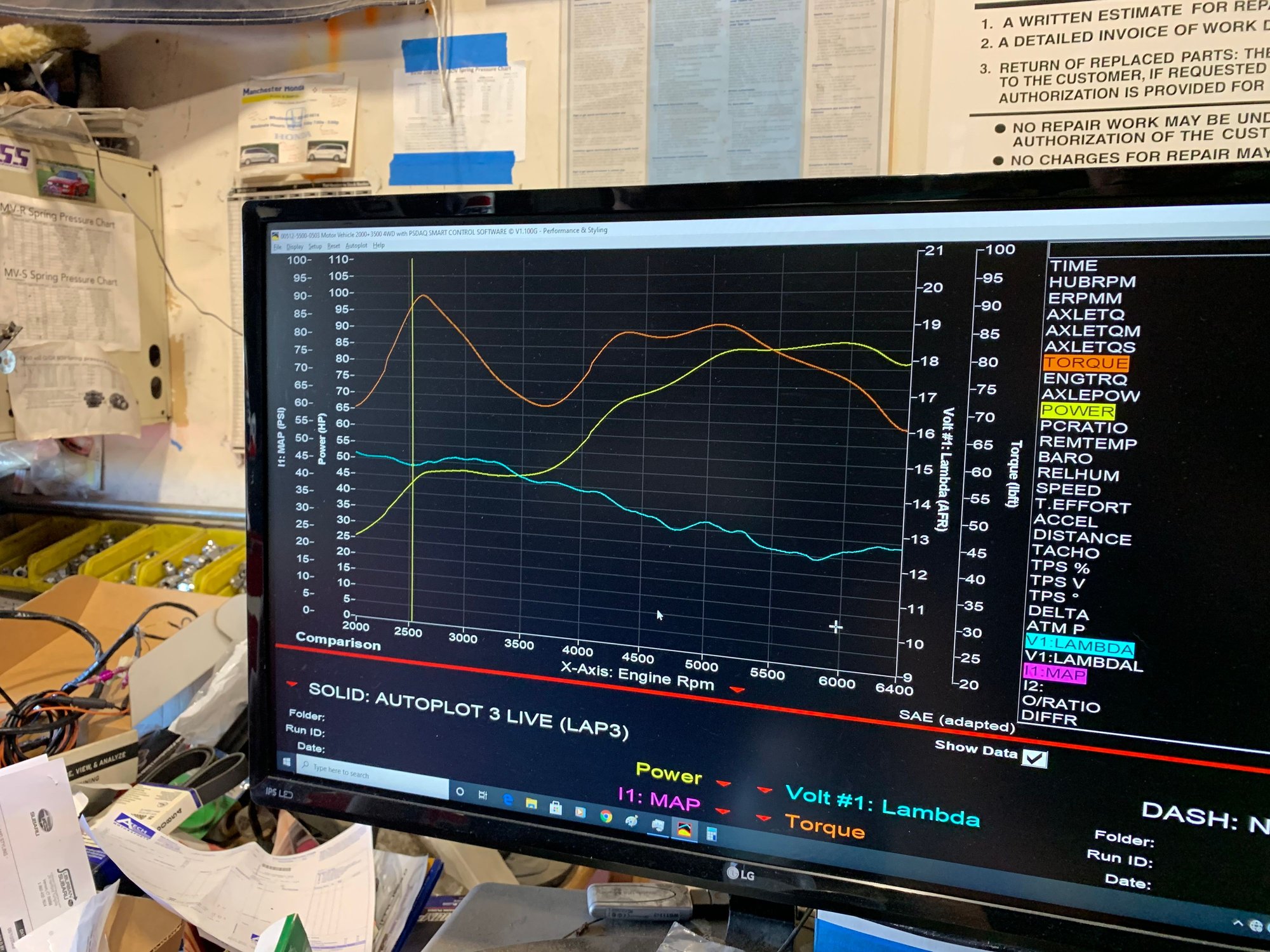

Made about 87hp to the wheels on a dynapak, I think my r53 throttle body may be causing it to lean out around 3000rpm then the car is dumping fuel…
I did this as a baseline before Adrian tunes the car,

I'm willing to bet the resonator delete is having an impact. As the name implies, a resonator resonates at a particular frequency (and its octaves). This is defined by the length of pipe from your exhaust valves to the resonator. When the RPMs hit a certain point the frequency of the exhaust strokes (waves of exhaust gas pressure) from the cylinders will match the resonate frequency of the exhaust pipe. When this happens you get a sharp drop in back pressure and a slight bump in torque and HP.
By removing your resonator, you have a longer length of pipe (your muffler has now become a resonator) and therefore a lower resonance. This gives you more low end torque while sacrificing mid-range torque. Exactly what your curve looks like.
BTW, the same effect happens in the intake manifold. The variable being the length of the runners between the plenum and intake valves. Many car makers have gotten clever with this and have system to effectively change the length of the runners in real time (see BMWs DISA valves as an example).
Side note, I'd also be curious to see ignition timing overlayed on the plot. If for some reason your knock sensor is generating signals the DME may be retarding the timing.
Another side note, the A/F is nearly stoiciometric up to ~3,700RPM. Re-mapping it to be richer at WOT will help with power and torque at those lower revs.

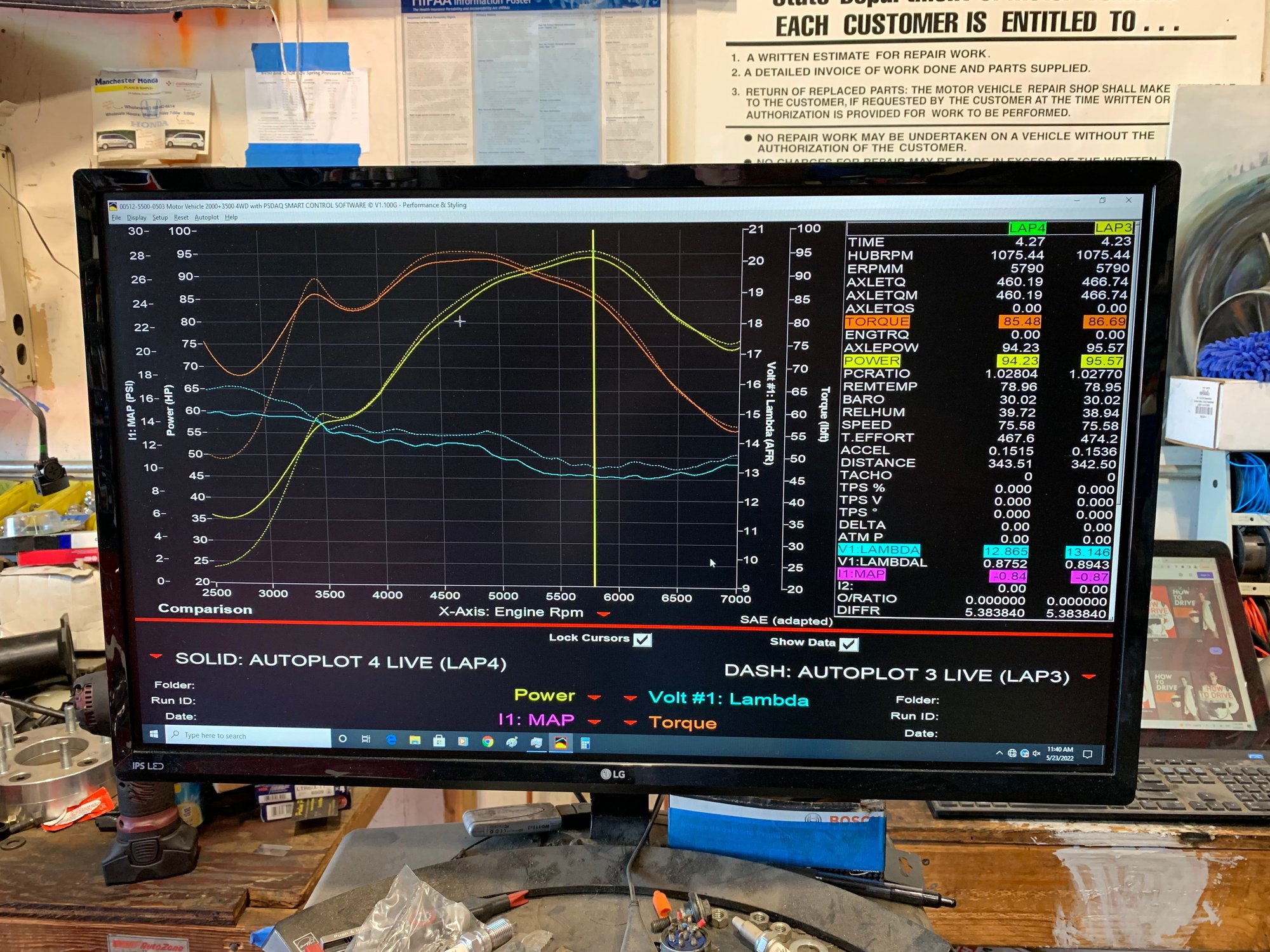

Finally got back to the dyno after Adrian’s tune, first pulls were disappointing. Made exact same power and the power curve was all over the place.
then I swapped the factory throttle body instead of the r53, the car immediately sounded better and the power curve was way smoother. Ended up making approximately 10whp off Adrian’s tune. Up to 97whp on this dyno
the first chart is with the r53 tb, the second chart is two of the runs done with the stock tb…
