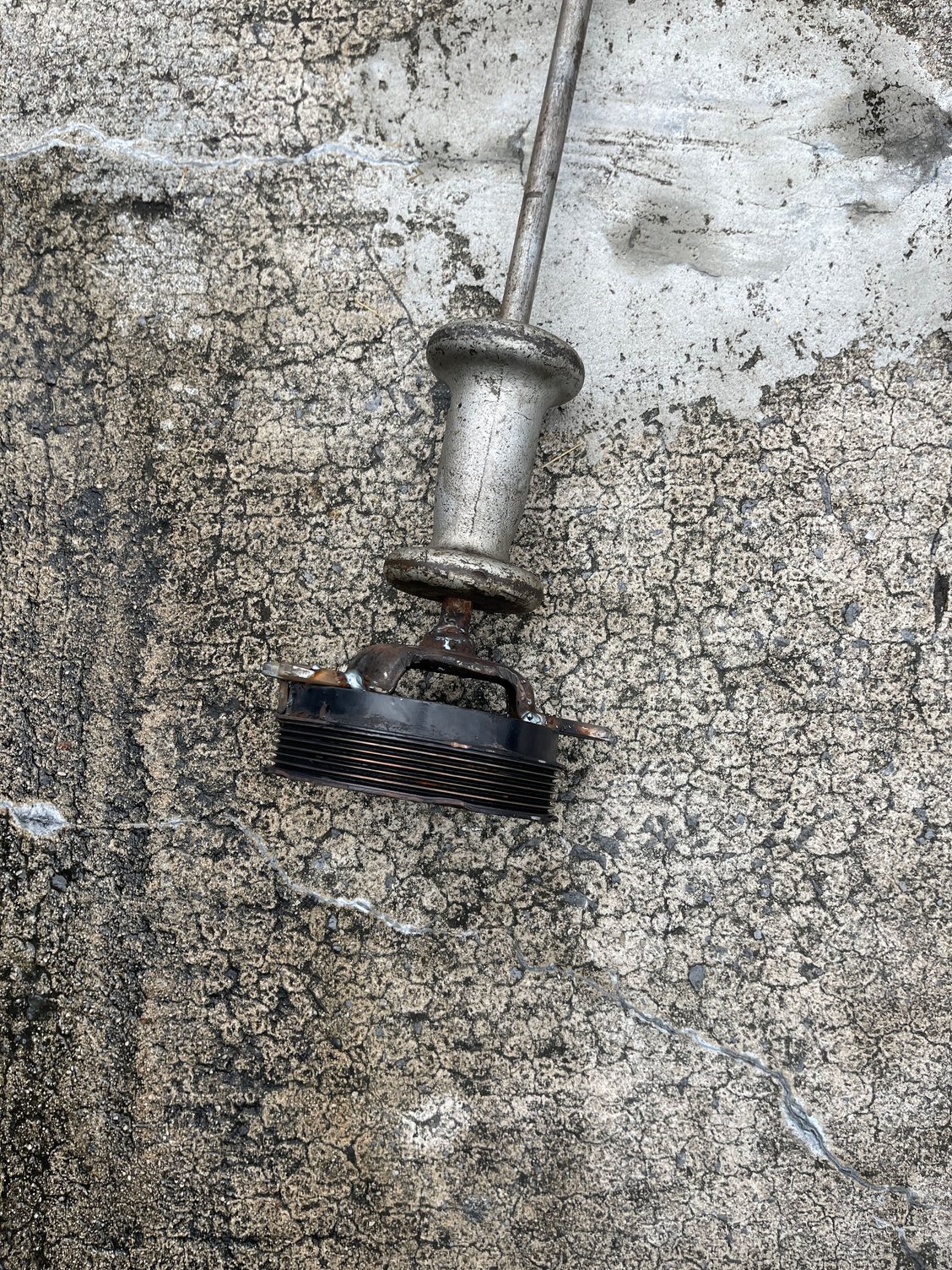

I have a 2003 MCS R53 W11 engine. I got a spray of fine clean oil on my back window from one trip to the grocery store and traced it to a glub, glub, glub leak out of the hole the crankshaft is jutting out of.
Dumb me, I did not replace the crank seal a couple of years ago when my stock type pulley fell apart. I looked around for my puller and bolts. Apparently, I have discarded them. New puller and 6x70mm bolts. washers not big enough. I stacked different size washers. I loosened the crank bolt and put it back in 4 or 5 turns with the fingers and aligned my puller trying to keep it on straight. Engine spins so I got the impact wrench. It pulled it out some but it bent up the three 6 mm bolts. With new 6x60mm bolts, I try again and I pulled out the threads of one of the three holes when it ejected one of the 6mm bolts across the garage. No jaw puller can get a bite. So am I going to have to weld something to it and use a slide hammer like below or is there another method? tap out the screw holes to something meatier? Tow it to a shop?
The crank bolt still has 3/8" left before I have to get a longer bolt or put a smaller headless bolt into the crank snout like the video below. This pulley is like the stock pulley.

These three holes are M6x1.0. Should I try and tap them to M7x1.0 or M8x1.25 just so I can get this thing off and buy another $200 one?

This is the puller I use to pull my harmonic balancer. It's branded Matco but I'm pretty sure a puller in this style can be found online or maybe Harbor Freight for less than I paid Matco for it. The rod in the top of the picture laying under the pulley is not part of the kit. That rod is one of 4 rods from a Lisle brand pulley that I use with my Matco puller to get the W11 pulley off with.
