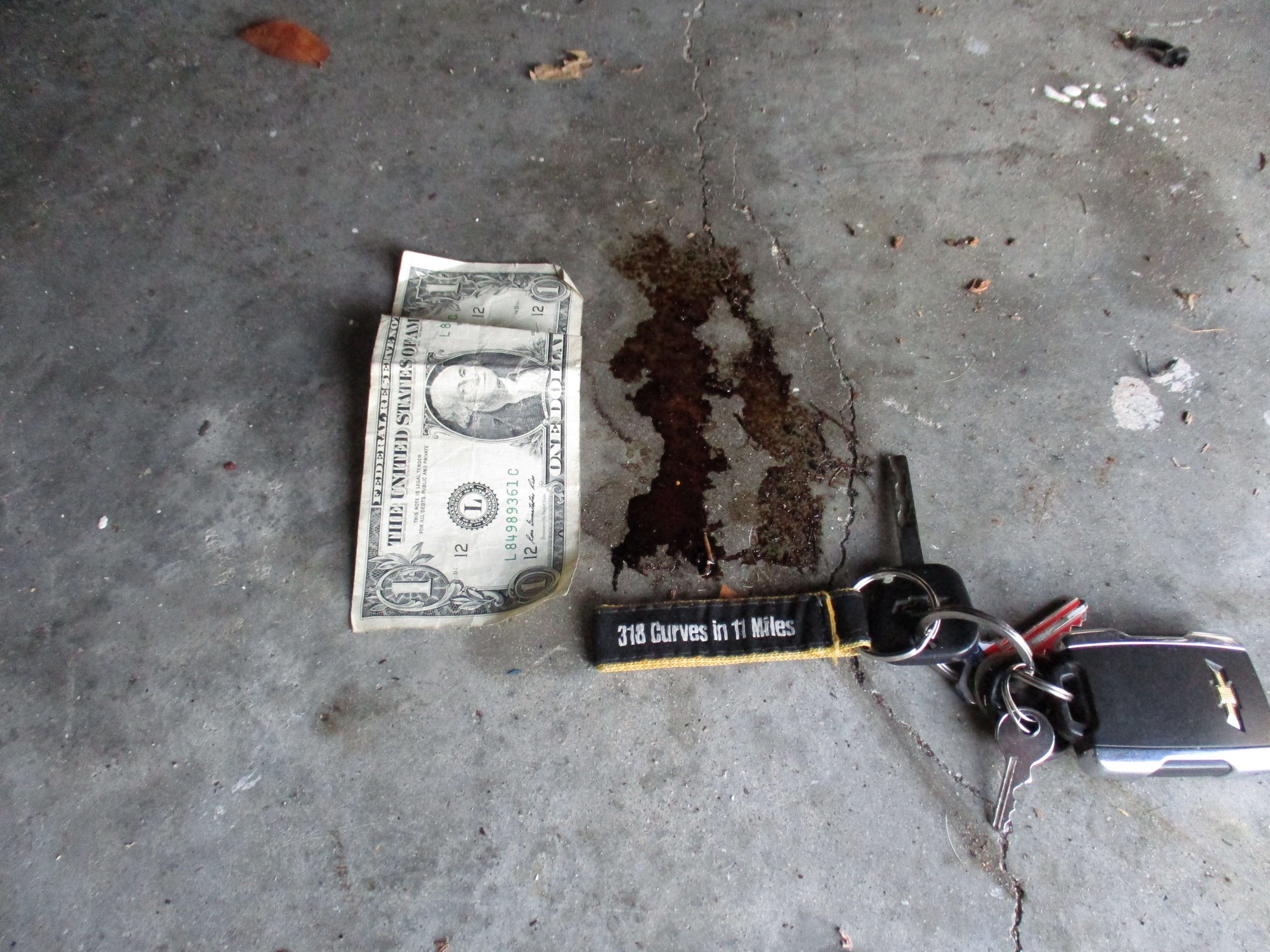

OK thanks fellas. 100% not the oil cooler, adapter or filter assembly. All of that's been done recently and its powder dry. She is up on stands with the front end off so I can get a pretty good look. I just climbed under there with a point and shoot camera and have narrowed it down to a timing cover gasket or cracked pan. Please offer your opinion of which.
The car has not run in a month.
The pan can be sprayed perfectly clean and dry and will make this puddle in two days.
** IS THAT A CRACK OR CASTING MARK? **
Two Days Drip
Crack or Casting line?
This was spotless two days ago when I gooped the cover bolt. See the oil on the back of the cover?
Cooler is not leaking and its not a pressure leak anyway..It drips 24/7 running or not..
