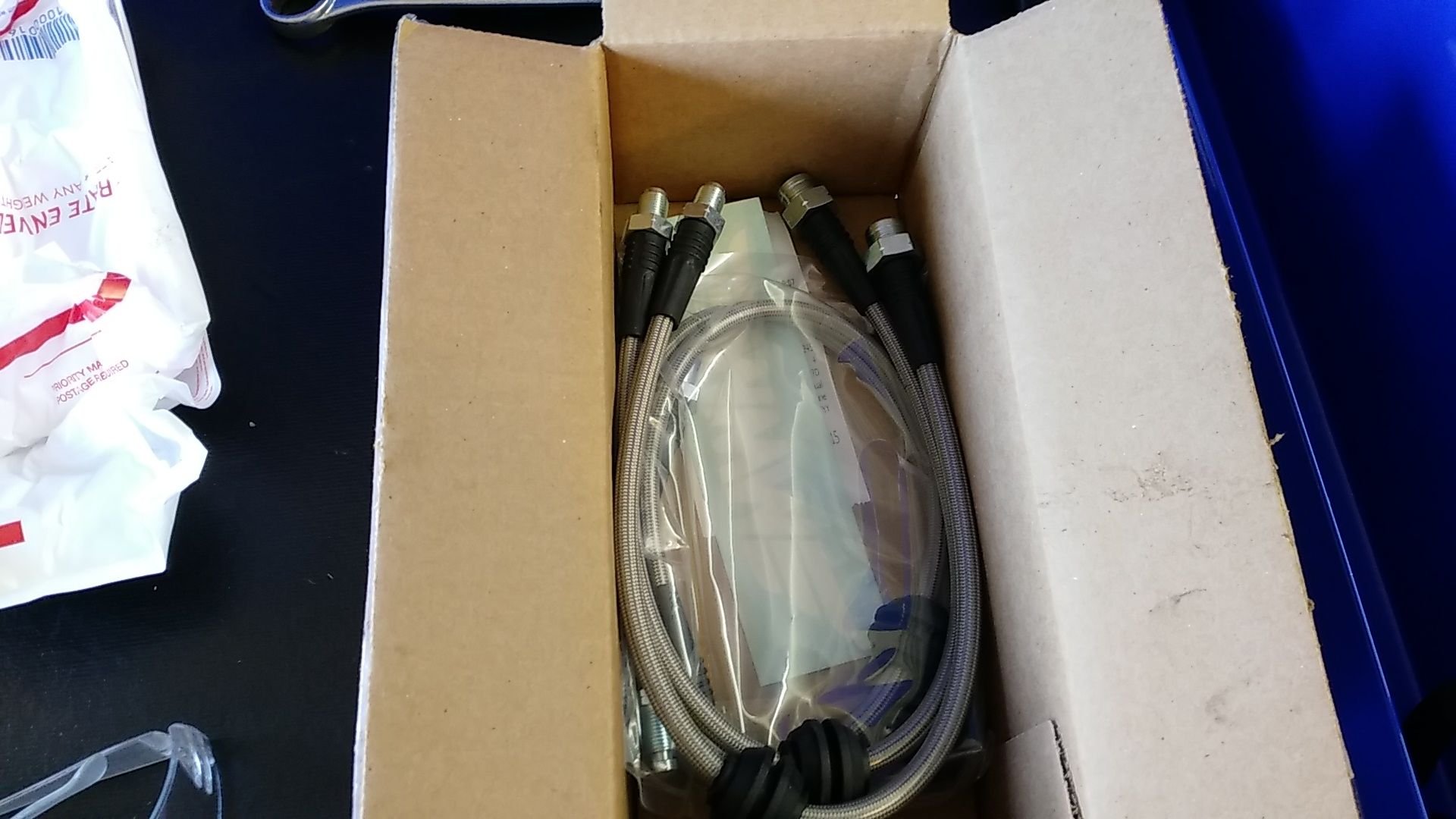

Just picked up another R53. On my current R53 driver I have the R56 brakes, SS lines and X-lites.
On this new one, I've got stock brakes and R81's (aka Holey's)
I would like to swap the R56 brakes onto this car (They make that much of a difference!) as well AND keep the Holey's Of course they do not fit (I tried on the other car) - and I could swear someone did some sort of mod before to make it work. I cannot seem to locate the info.
Can anyone help me out? I really love the lightweight of the Holeys and would like to try and keep them if possible.
