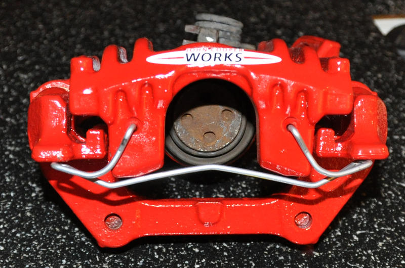

The simple answer here is to do exactly what MINI/JCW did, change the pads.
If you want a little more, both performance and looks: see post #11 and my article on the Rear Brake upgrade.
The Factory Rear can be upgraded to perform better and look better on the cheap.
BUT always remember that 2/3 of the braking force for the car are on the front, so no need to go crazy.
I just completed the photo'ed ones for a friend that is going to add the SS Lines and the EBC Red pads.
Attached Thumbnails R56 JCW Brakes Front and/or Rear-dsc_4710.jpg   R56 JCW Brakes Front and/or Rear-dsc_4709.jpg
