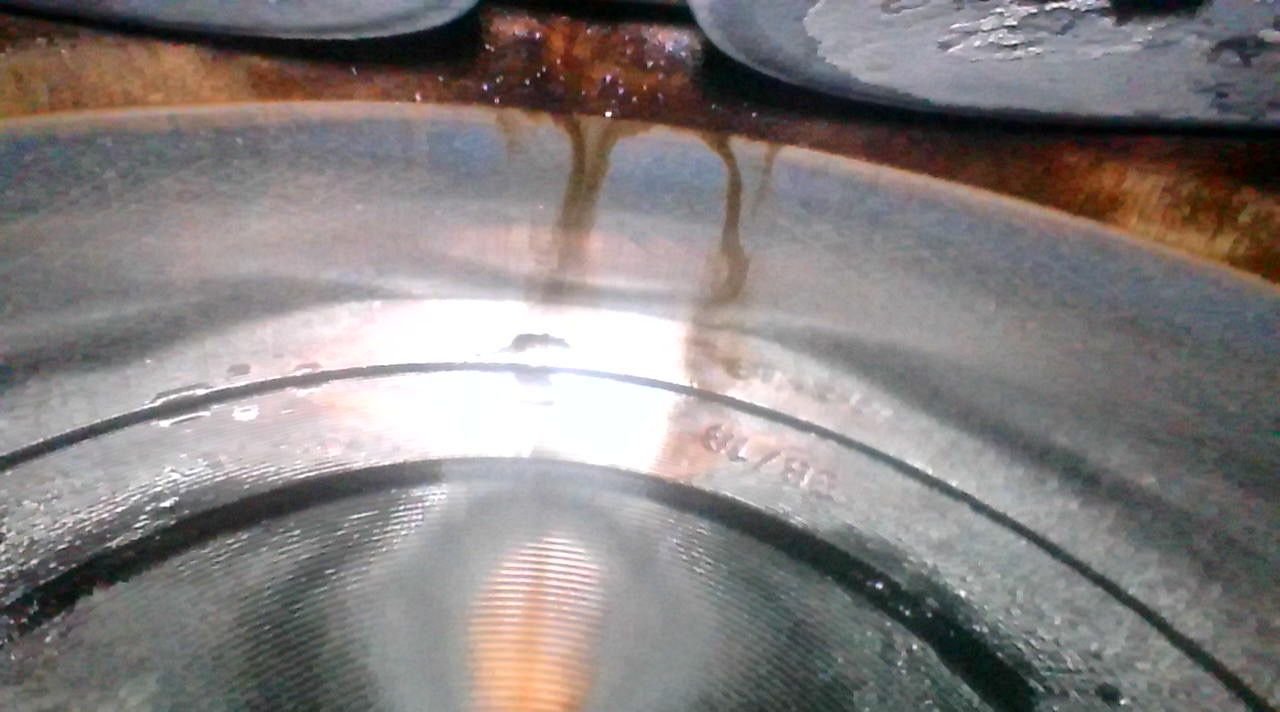

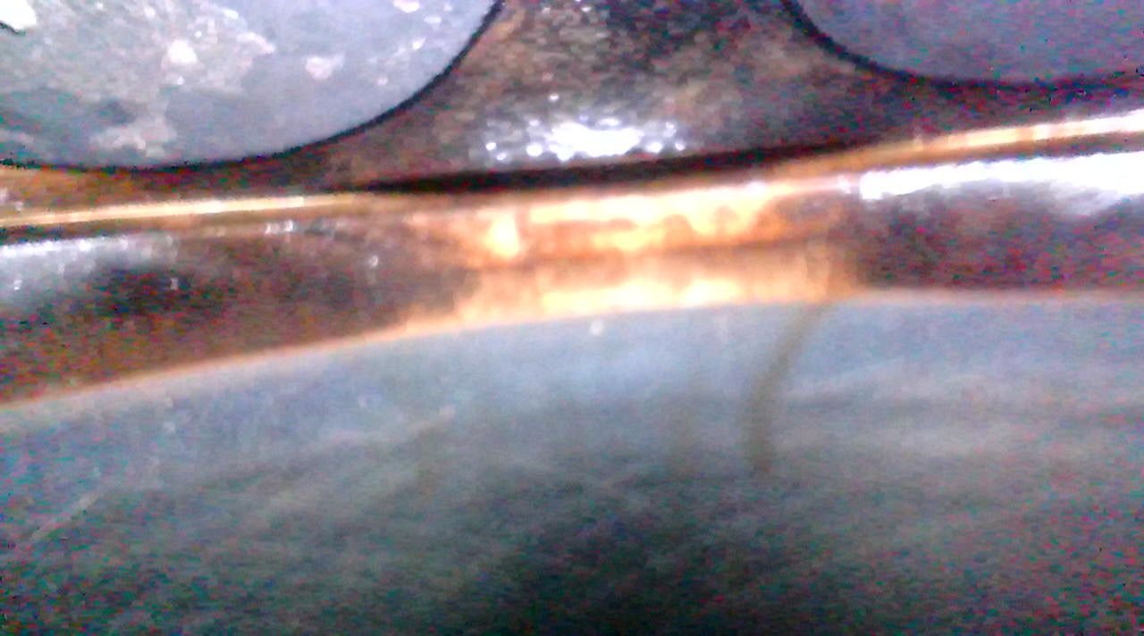

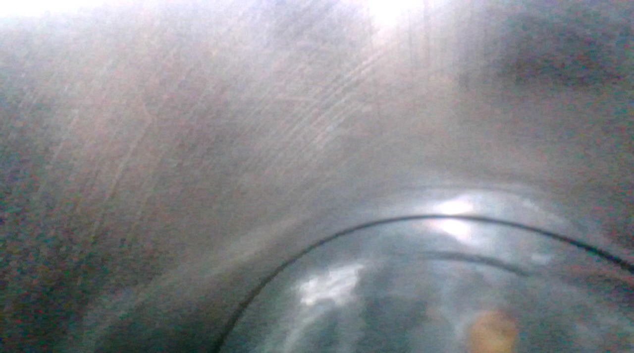

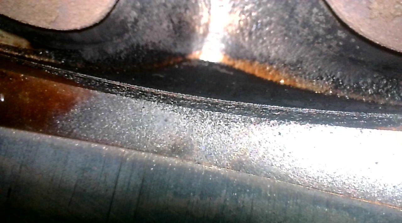

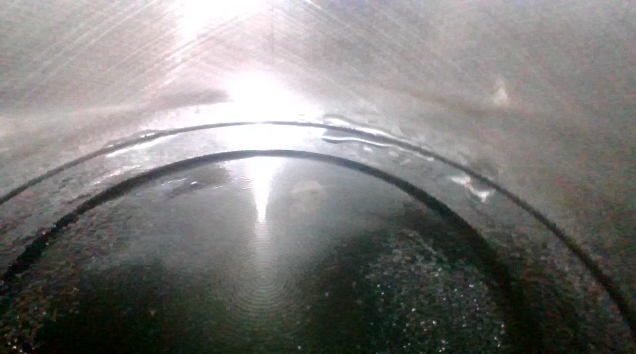

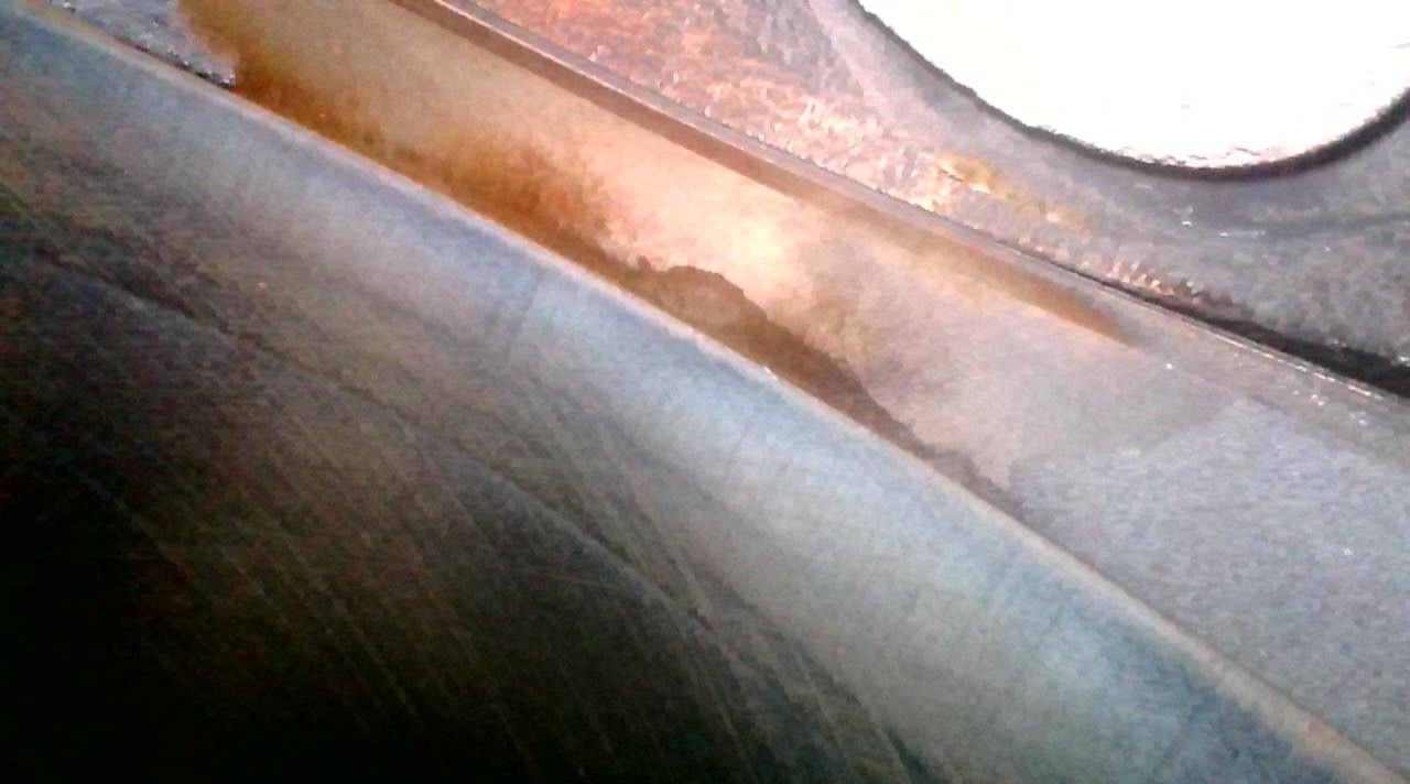

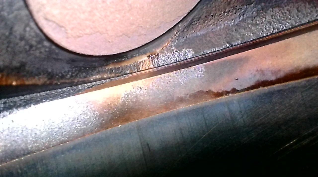

I did a leakdown test, didn’t show anything obvious. 100lbs in the cylinders and nothing happened in the cooling system. But then I stuck my scope down in there. The first few pictures are stone cold after sitting at least 9 hours. The middle couple are after running a few seconds, the last few are fully warmed up. I think the rings are a bigger issue
