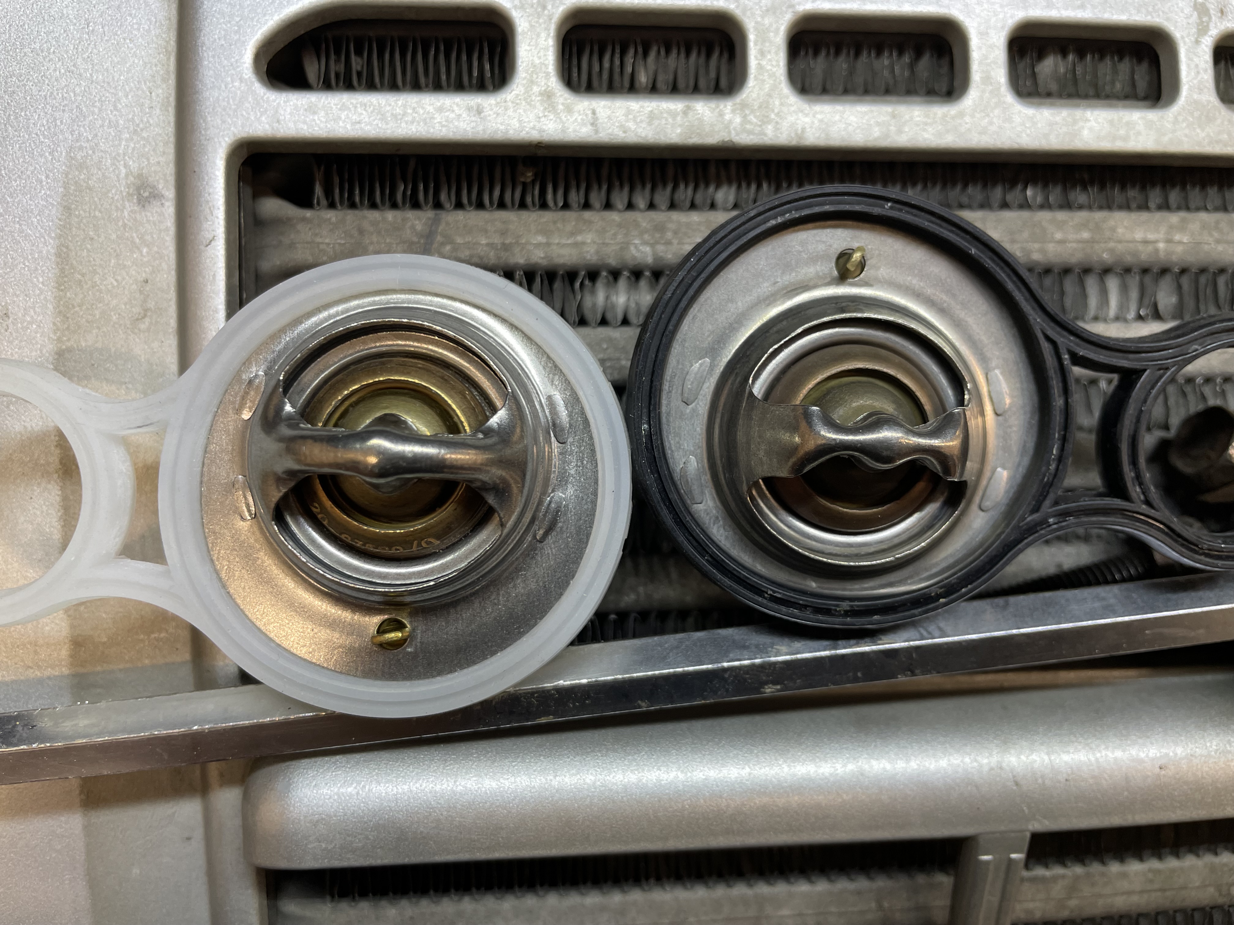

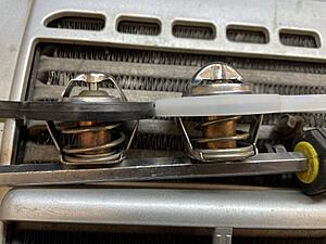

I ran it a couple weeks with no thermostat and 3/4 air blocked to the radiator. No air ever came out the bleed valve. Ordered a new thermostat and that fixed the warming up issue but I'm getting air out of it again. The first thermostat was a Rein and has a black seal, the last one I got was a genuine Mini with a white seal. Both say MotoRad, the white seal is just a hair thicker, the top crimp is slightly different, and the spring tension is tighter on the Mini thermostat which I'm sure that is the reason the first one took longer to warm up. The air that is getting into the system is not from the engine from like say a crack or head gasket or I would have still got air from the bleed valve when I had the thermostat out
Attached Thumbnails JCW coolant burp and glowing Milltek header-img_0658.jpeg   JCW coolant burp and glowing Milltek header-img_0659.jpeg
