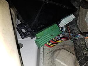

Oh lord. Look at the state of it. I'm gonna need some new plugs by the look of it. Might as well get a new BCU while I'm at it. Does anyone know how to unplug the GREEN plug from the box? I'm almost destroying the thing.

The green plug has a mechanical lock. You should be able to slide the top lock towards the left in the pics using the ribs to grip it. Once released it should just unplug.
Thank you kindly. I'll give it a go.

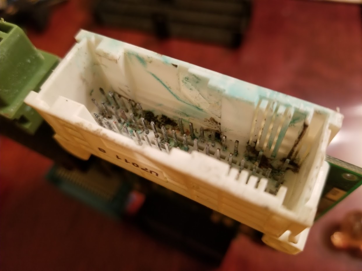

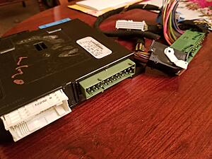

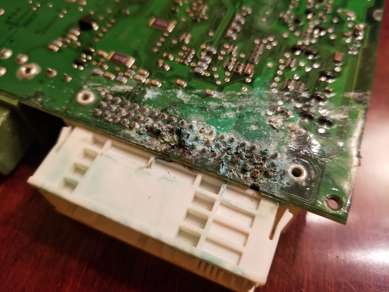

So I went ahead and ordered a second hand BCU complete with plugs. I managed to get that RIDICULOUS green plug off of these BCUs. It took a lot of struggle to slide it fully in order to disengage it. I then had a look inside my unit to see the condition. There's unfortunately some corrosion on one corner of the PCB by the white plug. I will see if I can unsolder it and replace it with the newer clean one. Does anyone know the best way to clean the corrosion off of my existing board without damaging it? Will some mild detergent and a soft brush take care of it?
Here are some photos of the BCUs. Cheers.

Some contact cleaner and a toothbrush should get most of the corrosion off without damaging the board.

I double layer PCB, hard to repair if it is heavily corroded.

I went ahead and ordered some CRC Electronic Cleaner to help lift the corrosion and clean off the PCB. I'll start on replacing the plugs of the BCM tomorrow. I have high hopes that it will clean up pretty well.
