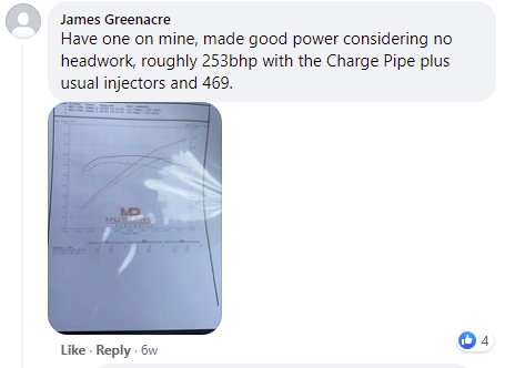

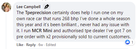

It was only some various brief commentary I came across on Facebook,
here's several for what it's worth...
