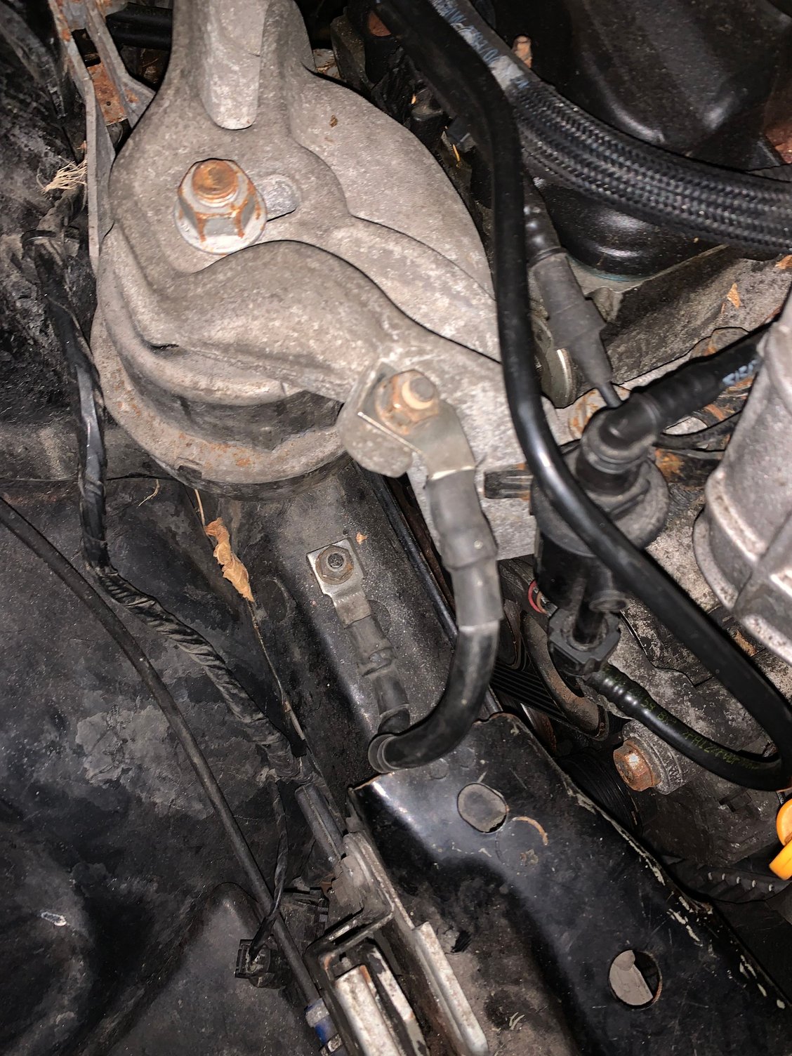

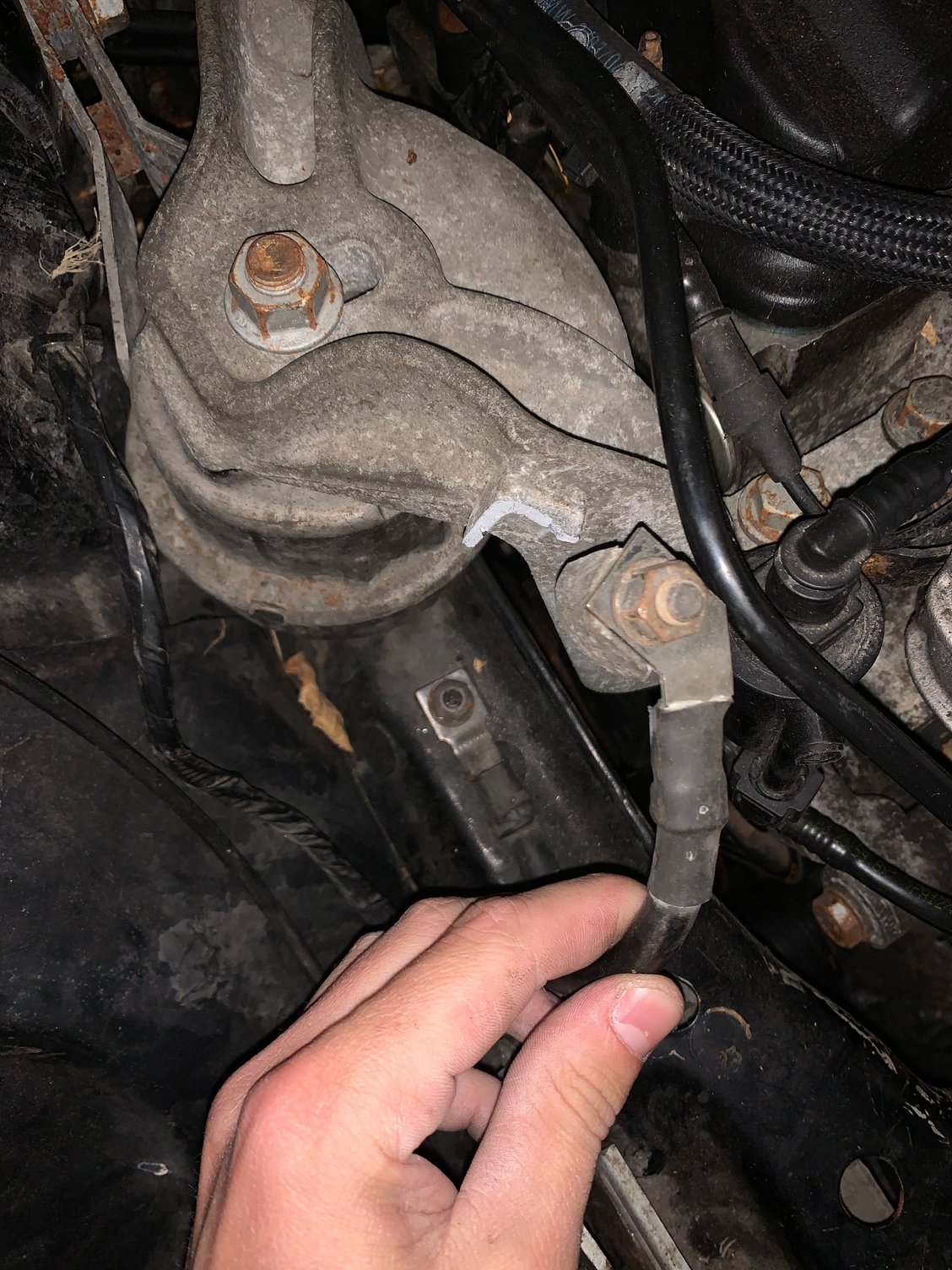

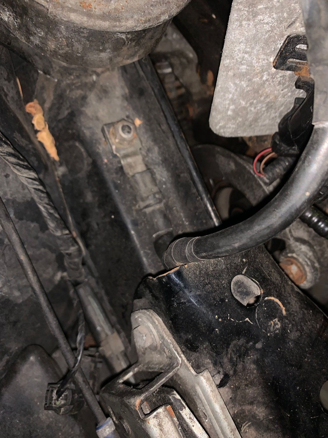

Well just got home from work and checked the ground strap off of engine mount.. took it off and immediately thought I had fixed my problem. The wire was being cut into and contacting the hood latch. So I took it off completely and taped up where the protective coating was cut, and cleaned up the connections.
went to put it back on and I was tightening the connection to the motor mount, and the bolt hole snapped off where the ground strap was bolted on.
My new question is: I was able to push the broken off piece connected to the strap back onto the motor mount where it looked like it was not broken. If the strap was the problem, would it still start even with that broken hole on motor Mount as long as they’re touching? Or would it need to be welded on for it to be properly grounded? Will add photos below
Old Nov 15, 2021 | 04:53 PM
KalebA1's Avatar
KalebA1
Joined: Nov 2021
Posts: 13
This is where it broke
This is how it was sitting when it failed to start(still broken just pushed back where it was)
You can see where I taped, that was where it was cutting into ground strap

Seems like the ground strap was severely fatigued. It only makes sense (to me), that the condition/connections were insufficient for powering the car.
I think your local auto parts store may have an inexpensive replacement. You may have to improvise what you buy but at least you'll have a better ground connection.
It might be worth a shot.
Just a thought.

what do I connect it to though now that the bolt hole it usually connects to is broke off the motor Mount?
Old Nov 15, 2021 | 06:57 PM
NC TRACKRAT's Avatar
NC TRACKRAT
Veteran: Navy
Joined: May 2006
Posts: 1,673
Likes: 305
From: NC
Lots of corrosion! See the big nut and protruding threads on the top of the motor mount? That's your best location for a temporary fix location. You'll need to purchase a similar but longer ground strap with a lug sufficiently big enough to fit that size bolt. After you do your temporary fix, you should be able to purchase a good, used casting from someone scrapping out their MINI.
p.s.: A word of caution. If you elect to install the lug from the new ground strap underneath the nut on the top of the engine mount, be sure to support the engine from underneath before you remove the nut.

I would change the ground strap. When I did my pulley I forgot to tighten my ground strap and there was a shock between me and my dad. I tightened it down and started right up no issues.I would also clean the connections
Old Nov 16, 2021 | 09:32 AM
MVPeters's Avatar
MVPeters
Joined: Dec 2013
Posts: 775
Likes: 145
From: Northern MA, USA
Kaleb
The ground strap provides the ground between the engine & the frame/body. So you can use any convenient nuts or bolts in either place. Just be sure the surfaces are sanded down to bright metal - clean, bright & tight.
