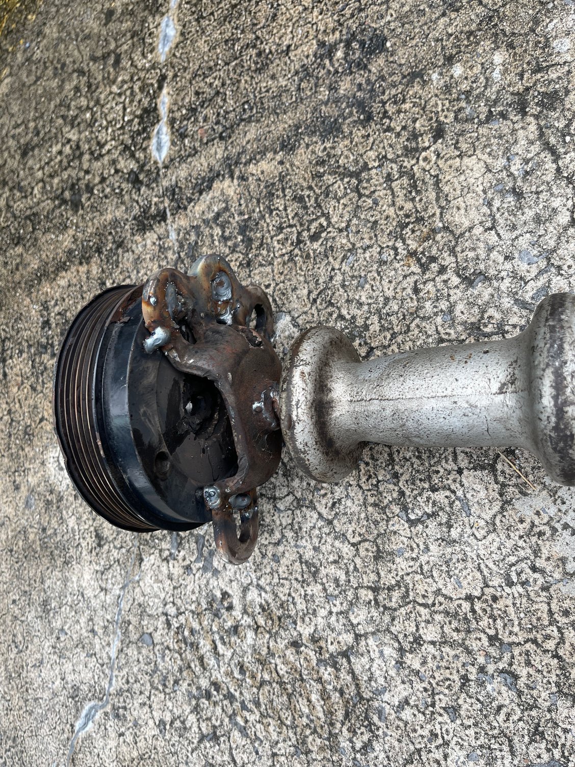

The front main was leaking like hell when I bought it. I ended up putting an ATI dampener and a new seal in. The timing cover seal was good and is still good. I replaced the rear main when I did the trans swap.
Do anything you think you need to do before you put it back in. The biggest oil leakers on both cars were the front seal, the oil pan gasket and the crank sensor O-ring. Knock on wood neither one of the Mini's leaks any fluids right now.
I could not get the dampener to come off so I ended up taking it to a German repair place. They ended up welding the puller to the pulley to get it off. A new seal and a new dampener and no more oil leak. . I pulled the dampener on my R52 and it came right off.

WOW! That's a serious solution!

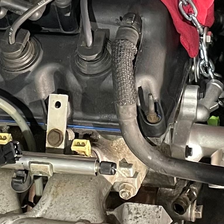

I saw those, wish they were red and not blue. I am replacing the gasket because I get a little bit of a burnt oil smell from the engine compartment. It's not leaking anything or anywhere that I can see, but that it the only gasket I haven't replaced.
Unfortunately, you can’t see the blue color once they’re installed. See?
