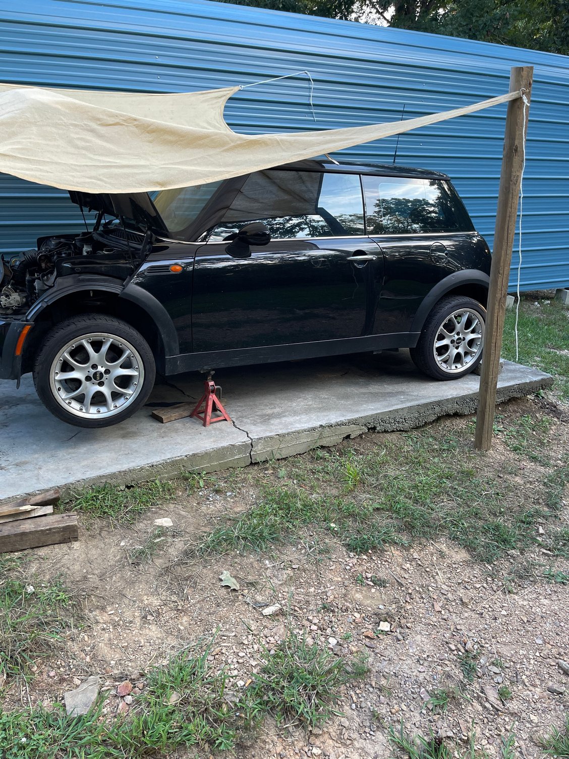

I got the new shifter and cables installed. I got the heat shields back up. I got the exhaust installed. I got the transmission filled with oil. I installed the new upper mount for the transmission. I ground off a little of the exhaust things that were hitting the bottom of the car. I got the bumper put back on and the rest of the rims put on. I am in a holding pattern till the clutch pipe is delivered. I am getting so close.

I got the pipe, slave and lock installed, put the battery in and fired it over. Something is scrubbing on the flywheel so I shut it off. It started raining again so I look at later. I has to either be the starter or I screwed up the clutch.
