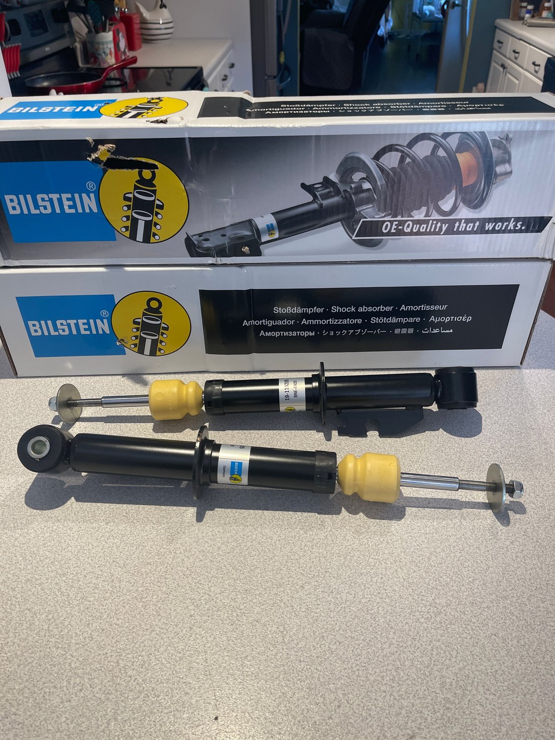

I got a delivery today! Still waiting on the front strut mounts and the rear bushings to be delivered. I took one of the backs apart and there was zero schocking action going on. I could push the rod down by hand very easily.
